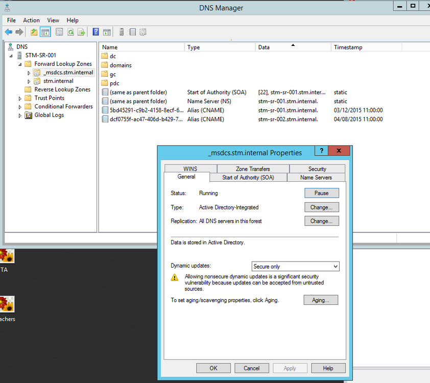

Hi, thanks, have taken a look and all I have in forward dns entries is shown in the attached screenshot.

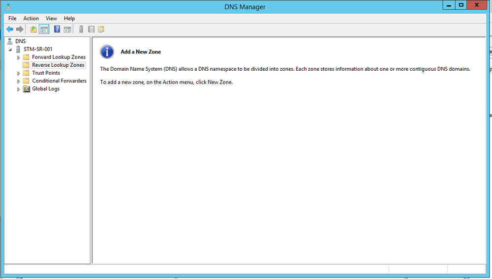

Reverse is empty.
[ATTACH=CONFIG]32299[/ATTACH]
Reverse is empty.

In your screen shot click on stm.internal, inside that folder you should have all the DNS entrys for all of the devices on your network. There should be one for stm-sr-002
