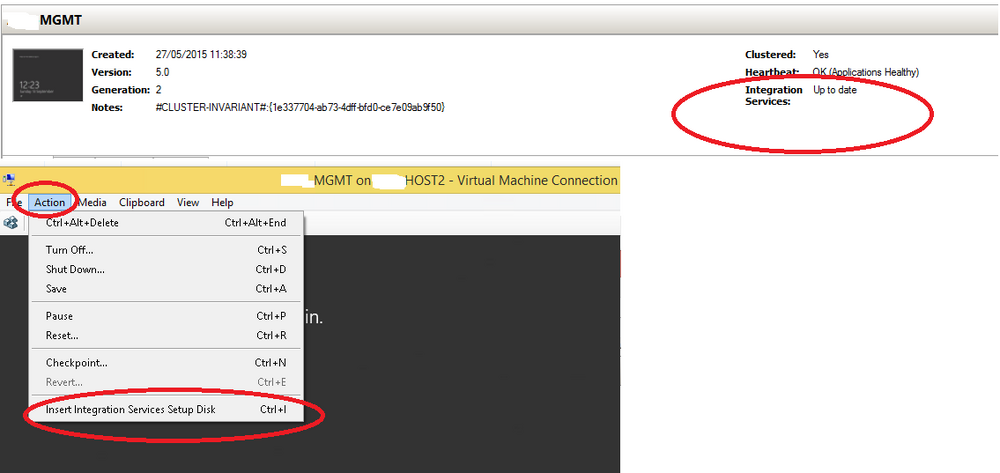

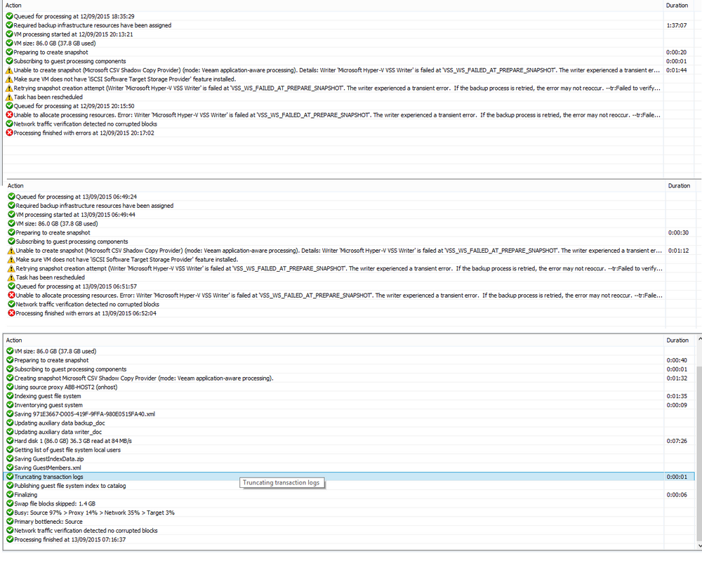

Steve21 Posted September 13, 2015 Posted September 13, 2015 (edited) For the integration part you need to do it via the HyperV server. If you connect to a server from HyperV manager or failover (not RDS) you get different options: In relation to the fails though, how many retries are you running? as I notice with ours if you're doing lots of servers at once they'll often fail 1/2 times, but then work fine another time without any need to change settings just waiting for the retries to occur and it works fine. Example below, same server once during main backup, and then 2 retries (we have 5 retries set in general): Steve Edited September 13, 2015 by Steve21 1
Gongalong Posted September 14, 2015 Author Posted September 14, 2015 Ah yes, well I've definitely got Integration Services installed, but I can't reinstall it. I just get the message it's already there. I've googled it also, and there doesn't seem to be any solution to removing and reinstalling. - - - Updated - - - We're running 3 retries. The jobs are sequenced so as not to collide, and even when I run them manually at times the other jobs don't run they still fail.
