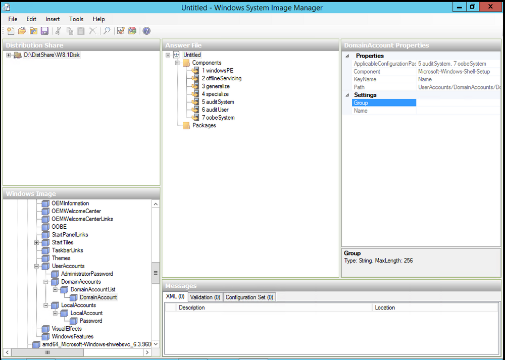

LeMarchand Posted July 30, 2015 Posted July 30, 2015 Can you add the support account during the imaging process?
GoodheadDC Posted July 30, 2015 Author Posted July 30, 2015 Can you add the support account during the imaging process? I think the support account setup in gp is also setup with various access rights groups etc.
LeMarchand Posted July 30, 2015 Posted July 30, 2015 I think the support account setup in gp is also setup with various access rights groups etc. If it's a domain account that you're making local admin could you not set it somewhere like the below so that it's computer admin but AD should preserve the domain permissions? Never done it - just throwing it out there!
GoodheadDC Posted July 30, 2015 Author Posted July 30, 2015 I have noticed that in gp we have a policy that renames local administrator to support. That's what we wanted to make it more secure. Lower down in the same policy we have a setting that disabled the administrator account. Do you think there could be a conflict here? If it's a domain account that you're making local admin could you not set it somewhere like the below so that it's computer admin but AD should preserve the domain permissions? [ATTACH=CONFIG]31778[/ATTACH] Never done it - just throwing it out there!

LeMarchand Posted July 30, 2015 Posted July 30, 2015 I have noticed that in gp we have a policy that renames local administrator to support. That's what we wanted to make it more secure. Lower down in the same policy we have a setting that disabled the administrator account. Do you think there could be a conflict here? Strange that it was working OK until now if so. Sounds like a likely culprit, though.
