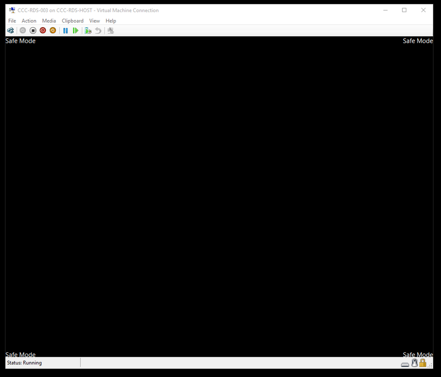

RowlandoGloom Posted July 24, 2015 Author Report Posted July 24, 2015 (edited) Even using the remote registry and adding: HKLM\Software\Microsoft\Windows NT\CurrentVersion\winlogon AutoAdminLogon = 1 DefaultUsername = administrator DefaultPassword = password doesn't work. I've attached some screenshots. I added the RM LogonUI Banner to see whether anything would show up: 1 minute it does: 1 minute is doesn't: Safe Mode just flickers there forever: Edited July 24, 2015 by RowlandoGloom
