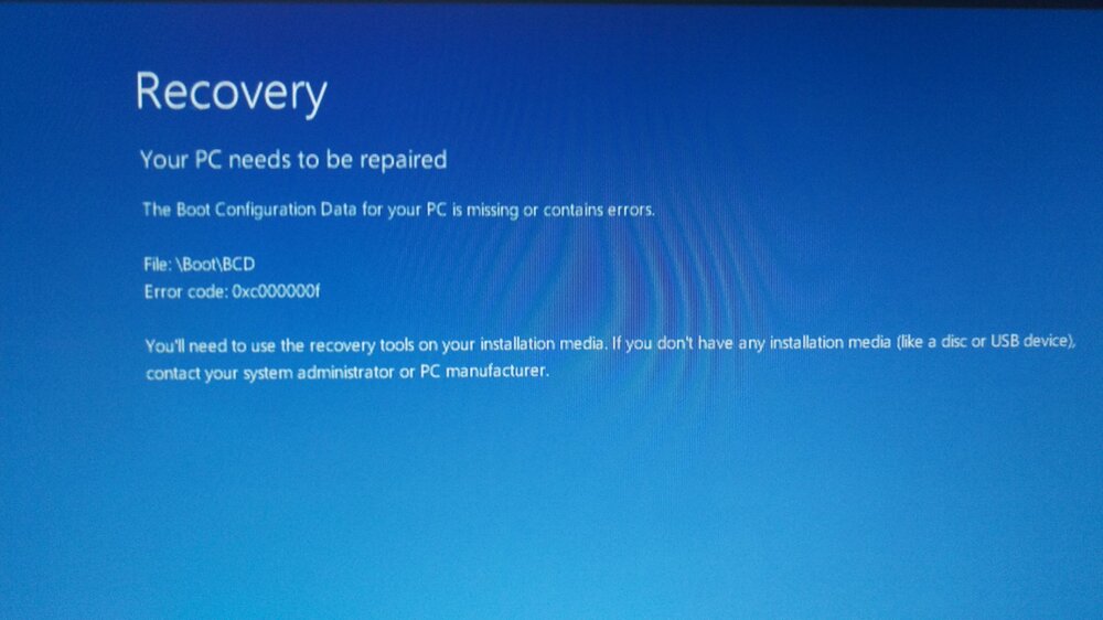

I have just built and new MDT Sever and have created the Boot Wim and iso. I have installed WDS (on the same Server) and added the boot Wim, however I get the following error.
I have tried using both the x86 and x64 boot wims and same error. If I burn the iso to a cd and boot it that way it works.
Any ideas?
Thanks

Sorry should have in in intial post, yes I have unfortunatley and tested with an without.
Hi Paul,
I get the error after the pxe boot screen, hit F12 and error appears.
I have added the nic drivers for the machine I am testing with and have updated the boot image including those drivers.
Also I have tried using both x86 and x64 boot wims.
Cheers

Try updating the MDT share and selecting to completely regenerate the boot images. Then import them into WDS again.
Take it you added the drivers to the out of box drivers in MDT? What version of MDT do you have?
Just kicked of a Complete regeneration of the boot image, Yeah I added the drivers there, also MDT 2013.
MDT 2013, ADK 8.1.

I have just mounted the boot wim with DISM to see if Update KB2919355 as I have read this can cause issues.
Cheers
Update,
The server is virtual, so I reverted to an earlier snapshot and installed MDT 2012 and ADK 8, still got the same error however.
