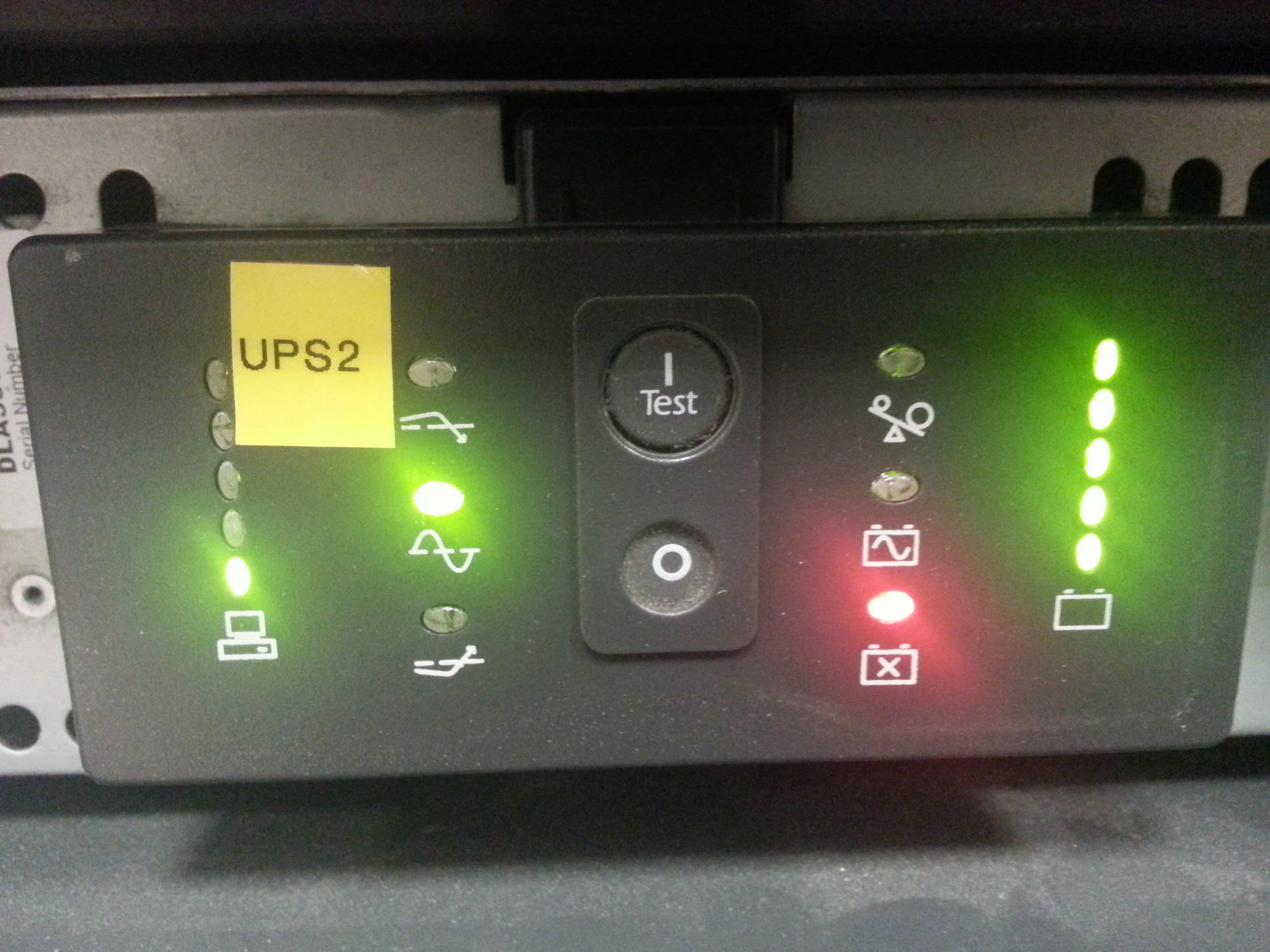

round2it Posted June 25, 2015 Author Posted June 25, 2015 Ok got the new battery fitted it but the red power light is still solid red at the bottom. I was going to wait till the morning and then run a self test to see if it will clear or do you think the whole unit my be a bit iffy and needed repair.
Oaktech Posted June 25, 2015 Posted June 25, 2015 That's normal. It will need time to charge the batts all the way up and then do a self test. It depends what it's internal self test schedule is but it could take some time to clear. The last one I did was a teeny little 750va jobby and it took a month to run it's self test and decide it was fine! 1
round2it Posted June 25, 2015 Author Posted June 25, 2015 (edited) but the battery indicators are fully charged. ah well if that annoying beeping sound stops every hour then I will be happy. I will let the battery charge overnight and do a self test to see if it actually works. will post back. I think it does a self test every 48hrs on this particular model. Edited June 25, 2015 by round2it
round2it Posted June 26, 2015 Author Posted June 26, 2015 the ups is now working correctly, I had to run a self test to clear the warning indicator, thank you for all your advice Rep given to all that replied
