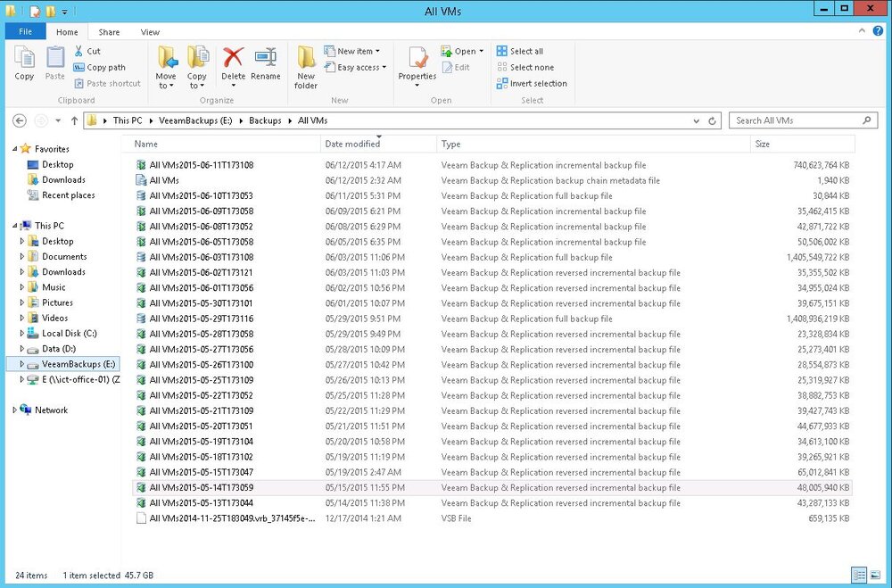

My Veeam backups are going to a 4Tb SAN which is now full.
For some reason there are two full backups on there as well as the incrementals. The two full backups are 1.5 Tb each !!
Can I just manually delete the older one of the two, or will that cause issues? I am pretty clueless regarding backups and I dont want to just delete it and then find out that there is some kind of keychain linking the incrementals to the full.
I have reduced the retention period, but the older full backup wont disappear for another 12 days.

I had a remote session on an unrelated issue with a Veeam rep last week and she changed our backups from reversed to forward.
The older of the full backups is sat in the middle of the reversed incrementals.
Using Incremental here and we only generally have 2 Full backups of each, this is due to setting Transform I guess and the fact that we do one active full each month. I would give them another ring.

If you're running out of space, you can manually delete the oldest backup chain (files from May 14th to May 29th). It won't affect integrity of other chains and you'll be able to restore from other points with no problem.
