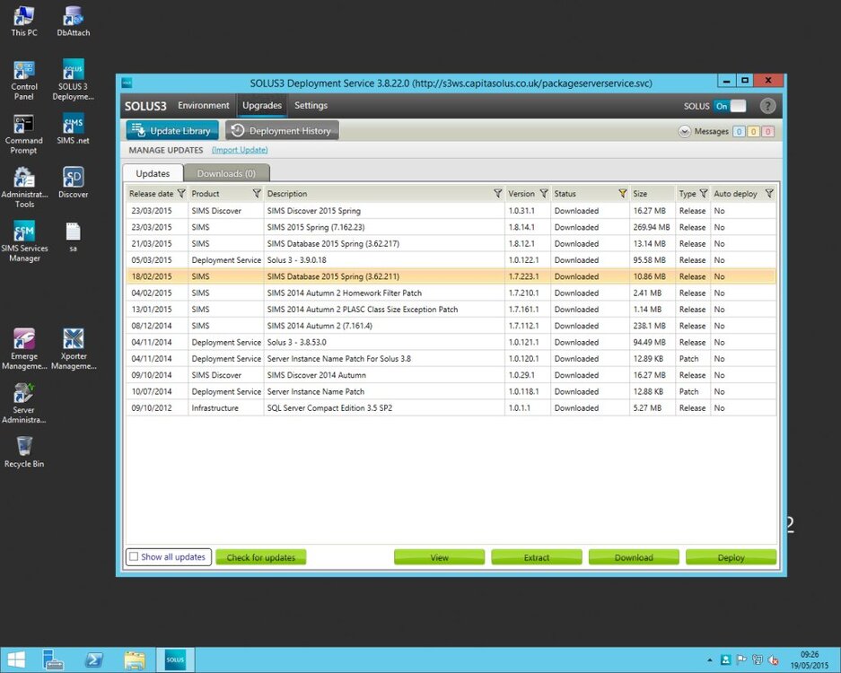

so would just clicking on 2015 spring install all of the required updates shown or do i need to click deploy on spring and then the database upgrades?
Yeah that's correct. Once you deploy the SIMS 2015 Spring update, you will see that it will upgrade the databases first. If this ever fails then you would need to check that you have downloaded the database updates within SOLUS 3, but looking at your screenshot, it is already there so you should have no problems!
