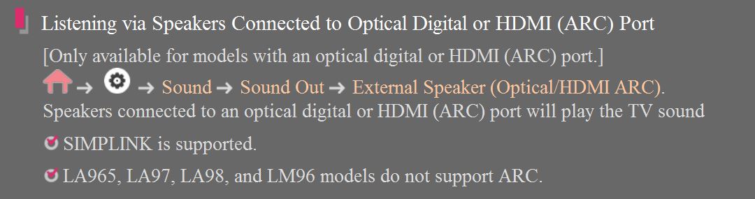

There seems to be some discussion over whether HDMI > Optical, but for your setup I don't think it will make a difference. Purely to maximize spare HDMI ports, I'd try removing the "HDMI 2" cable and using optical. You'll also need to set the sound output as below (assuming I found the correct manual!).
If no joy, try:
Sony - HDMI 1
Sky - HDMI2
and remove the optical (you may need to check the settings in the picture above).
