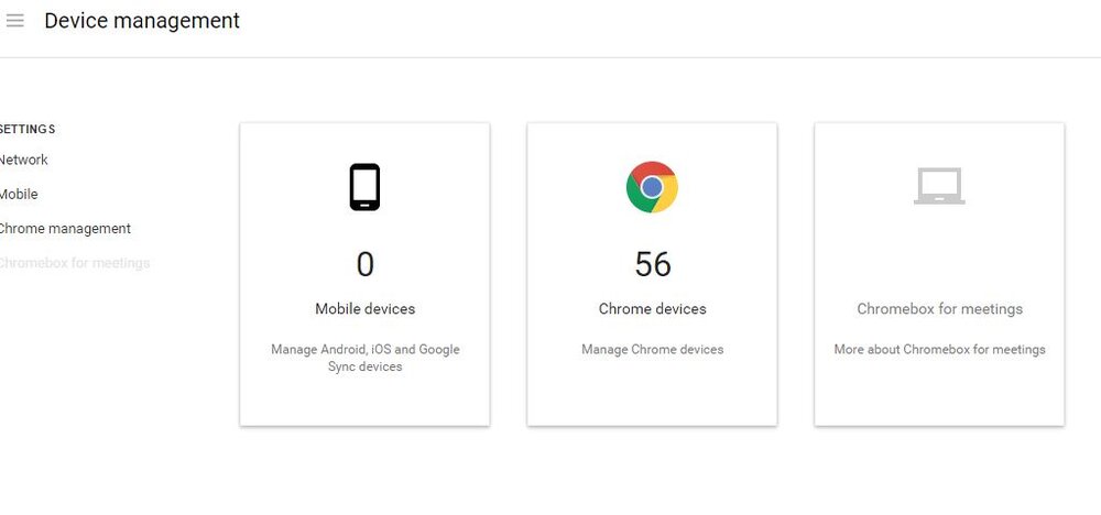

Finally managed to get it working but the "Chrome Devices" button in the Google Apps - Device Management section is greyed out. I enroled my device so was assuming this would make this active. Do i need to make more firewall changes for the Chromebook to communicate with Google Apps?
Do you have any google management console licenses for your google apps domain?
You have to purchase 1 per device that you add.
I though you got a licence with it when you purchase a chromebook?
Nope sadly not.
I have been paying an extra £19 for each license
