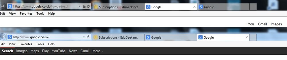

Also, how can I tell if this has actually worked?
I'm sure I used to get some ?gws_rd=ssl text or something like that after Google but now I don't...
Go to this link to see if the certificate has worked
https://protex-ssltest.e2bn.org/
you will get a screen stating "If you got straight here without a browser warning the E2BN Protex RootCA certificate is installed ok on your device."
