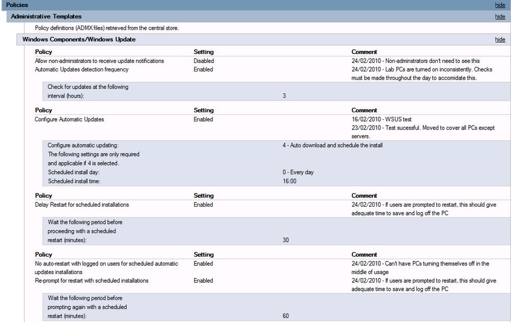

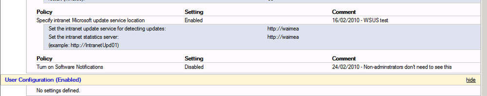

WSUS has quite a bit of flexibility and you can set updates to occur automatically at scheduled times. We have ours set to automatically download new (approved) updates and apply them at 4pm every day, after all classes have finished. The computers will reboot as necessary to apply the updates. This eliminates the problems that you are having with updates applying during the day or "building up" over time for the computers that are rarely used. It sounds like you don't have your GPO settings configured correctly to accommodate this. I've attached a couple of screenshots showing our WSUS configurations for our PC Labs.

I have setup the GP in a very similar way but I will double check it. I think I have set it to install at 3:00PM as they are turned off at 3:20 when school finishes. Do you leave your computers on after school? All the updates have different requirements, some will install/configure while turning off and others do it when the computers are turned on. So how is this handled?

We use the "Green FOG Service" to shutdown all computers at 8pm. We don't turn them off until then to provide time for all updates to apply and also in case we need to remote into any systems after school ends to do any work. If they all shut down at 3:20pm then we would often have to go around turning things on. All of our computers turn back on at 8am so any updates applied at startup will be completed before students ever arrive at school.
