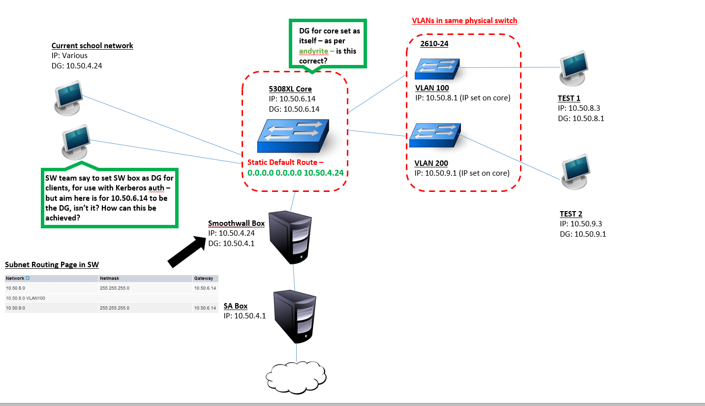

Is this what we need to have in place? Bit confused as advice from DMcCoy and andyrite seems to conflict - Do I need to dial the VLANs into SW, or not? Apologies for inducing much hair-pulling for folks..I think we're getting there. Easy when you understand the flow of traffic.
We are not adding vlans into the SW. We are just letting it know what subnets are on the network.
Why not change one of the current school networks computers gateway to the core and see if it work's.
So doing this will test whether internet destined traffic is routed correctly through to SW, from the default 0.0.0.0 0.0.0.0 10.50.4.24 route?
