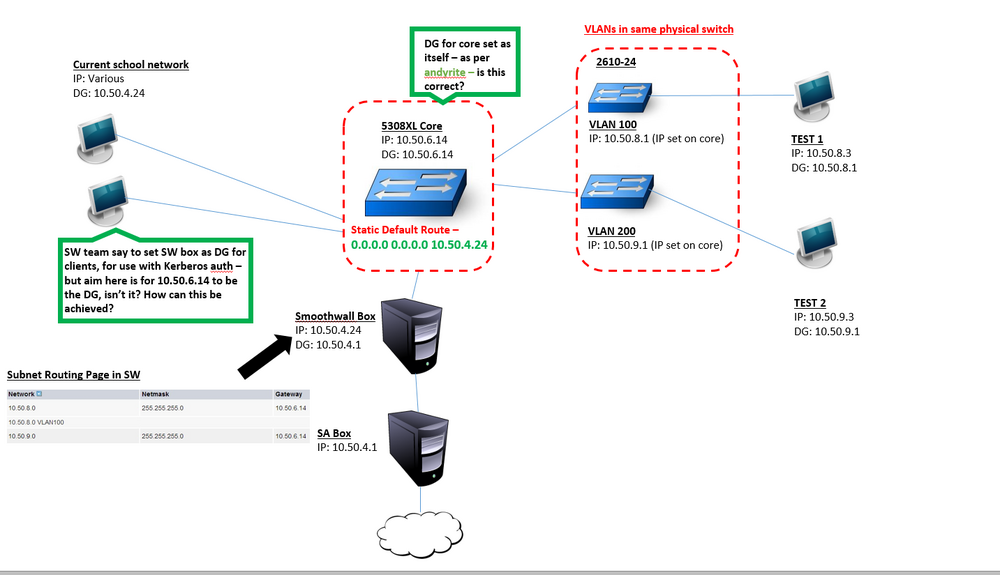

We use a Smoothwall box for filtering of internet traffic, which is set as the DG for all LAN PCs, with the exception of the IT office machines.
Would anyone be able to take a look at the image I have below, to help us resolve some of the new issues, please?
http://www.thedash.org.uk/VLANQuestions.png
Many thanks.
You should have a ip-route 0.0.0.0 0.0.0.0 10.50.4.24 on your core. If it doesn't know what to do with the traffic(ie not a local IP) it will send it to the smoothwall. You need to have your vlans setup in your smoothwall too.

Am I correct in thinking that this solves the issue of devices in the 100 & 200 VLANs not being able to reach the internet, but not the issue of PCs using the 10.50.4.1 DG being unable to contact devices in VLANs 100 & 200?
Yes. The smoothwall wouldn't know what to have done with the traffic.
The pc won't know how to get to the ip so will send it to you dg (the SA BOX) You'll need to add some static routes to your pc because you are not using the main switch for routing.
What are you using the SA box for?

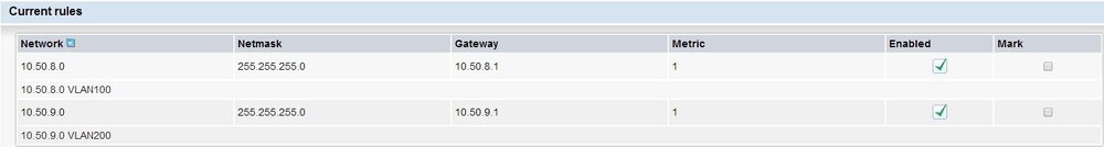

Screenshot of the SW vlan page.
The local routing table on the SW box reflects these changes also.

The Gateway in the VLAN screen on the smoothwal needs to be 10.50.6.14 for every vlan. (the switch is doing the routing)
As 10.50.6.14 isn't local for either of the VLAN IP ranges, Smoothwall won't allow us to enter this as the DG..
You do not need and additional VLANs on the smoothwall, just the main interface and a route back for the relevant ip ranges.

Can I ask why you're implementing such a convoluted method of routing?
The setup we have here is:
All VLANS have the core as their DG (using the VLAN IP for the DG address).
The core has the rule "ip route 0.0.0.0 0.0.0.0 10.5.143.254" in place, which is the default rule sending all unknown traffic to our edge router. In your case, this would point at your smoothwall box, which would have a DG of your edge router.
From what I can tell, you're trying to route using your smoothwall box before the core router, meaning you have to bounce traffic back and forth.
Is there a specific reason you need to do it that way?
