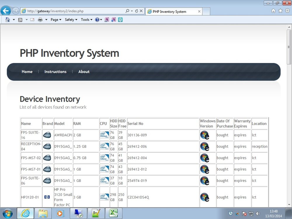

sted Posted March 13, 2014 Author Report Posted March 13, 2014 now even got the web frontend working it seems to add random blank lines to the csv but ive decied meh i can either a ignore them or b delete them lol
