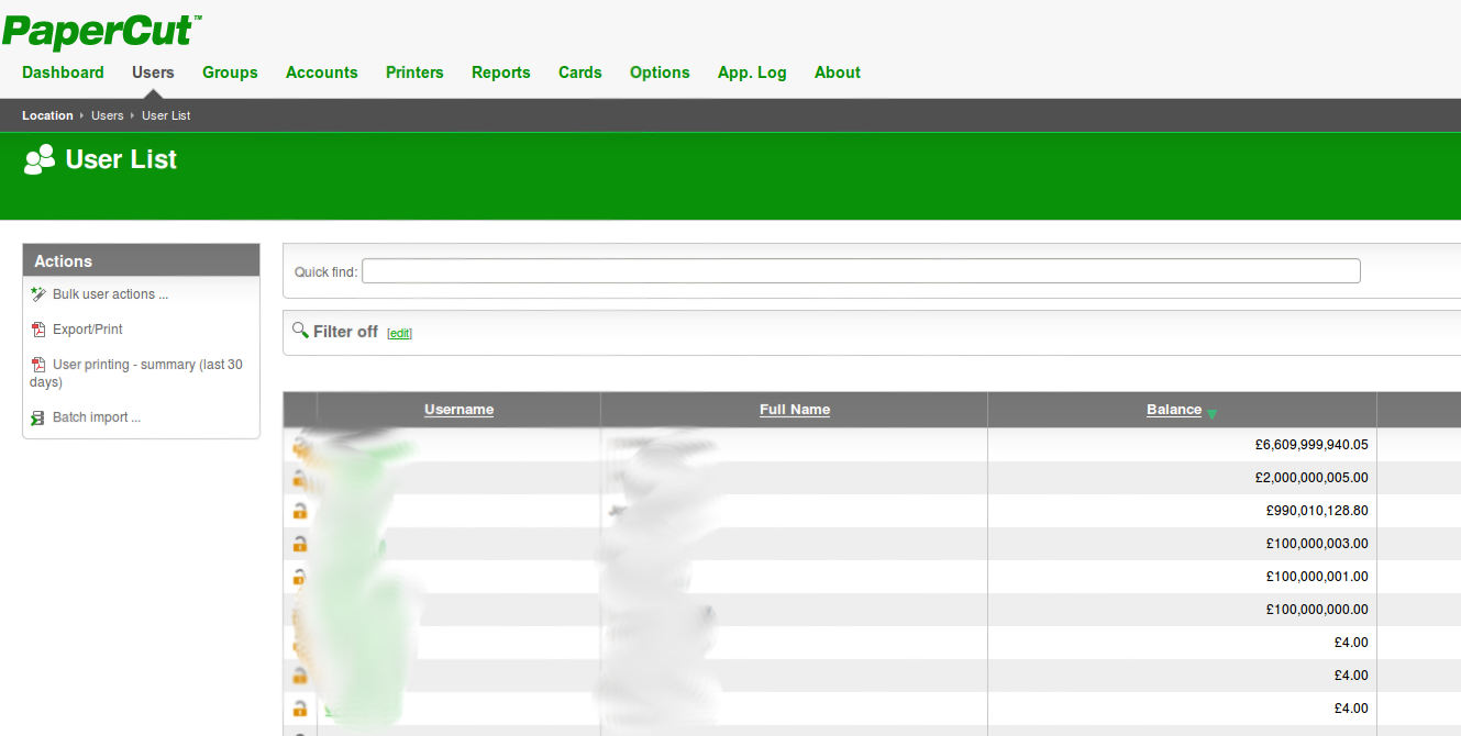

JJonas Posted February 14, 2014 Posted February 14, 2014 (edited) We are new to this, dont think it is quite set up correctly as they have now discovered they can transfer to each other unlimited money (see pic) How do I stop this? Edited February 14, 2014 by JJonas

Willott Posted February 14, 2014 Posted February 14, 2014 Have you got user accounts set to unrestricted? 1
TronXP Posted February 14, 2014 Posted February 14, 2014 Have you got "allow users to transfer funds to other users" enabled in the options?
foofighterjim Posted February 14, 2014 Posted February 14, 2014 The two option you need to remove are as @TronXP says the "allow users to transfer funds to other users" and prevent the student accounts from going below £0. I don't recall the setting name but this should resolve the issue.
JJonas Posted February 14, 2014 Author Posted February 14, 2014 The two option you need to remove are as @TronXP says the "allow users to transfer funds to other users" and prevent the student accounts from going below £0. I don't recall the setting name but this should resolve the issue. Looks like it might be overdrafts Using Overdrafts they are now set to 0.00
