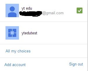

I got it working - somehow had linked a google + account to youtube and was adding the videos / playlists to the wrong one.
I find the whole google / google + / youtube experience very confusing....
Sorted now though, one account which I can add playlists/videos to.

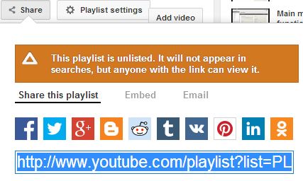

I have had huge problems with this - @kennysarmy has been helping me but I have come to a halt
I am able to create a playlist BUT I cannot do something with it so staff can see it.
I have taken the URL of the playlist and created a shortcut with it in GP but it tells me the address is unavailable with the education filter enabled. If I make a shortcut using one of the video's URL it just goes straight to youtube for education - not my playlist.
Can anyone tell me what I am doing wrong or maybe give me some more instructions? I have followed the instructions on creating a playlist very carefully but maybe I am going wrong with the sharing?

Yes, I did this and created it with no problems but I am unsure as to where the staff go to see this playlist
Edited by witch
They go to the YouTube channel where the playlist resides and click on the playlist and if they cant get to that then there is a misconfiguration somewhere. It sounds like you are doing it right but there is some simple problem somewhere.

I did log on at home with the school account - the one I created the playlist with. I dont have a personal YouTube account. So you are saying that when I go to YouTube for education I should be able to log in with the account I created the playlist with?
In fact, I think I have created three channels, because when I log in I get a choice of three channels. Is there a way of getting rid of the other two? If I do ever get this right, I can't have the staff logging on and seeing three- especially as two have the same name!

It asks me what I want to use YouTube as...exactly as above, the three channel choice. I choose the one that has the playlist on it, click OK. The page flashes up, then is greyed out with the same channel choice on top. I can see through the grey that I am logged on but cannot go any further.
