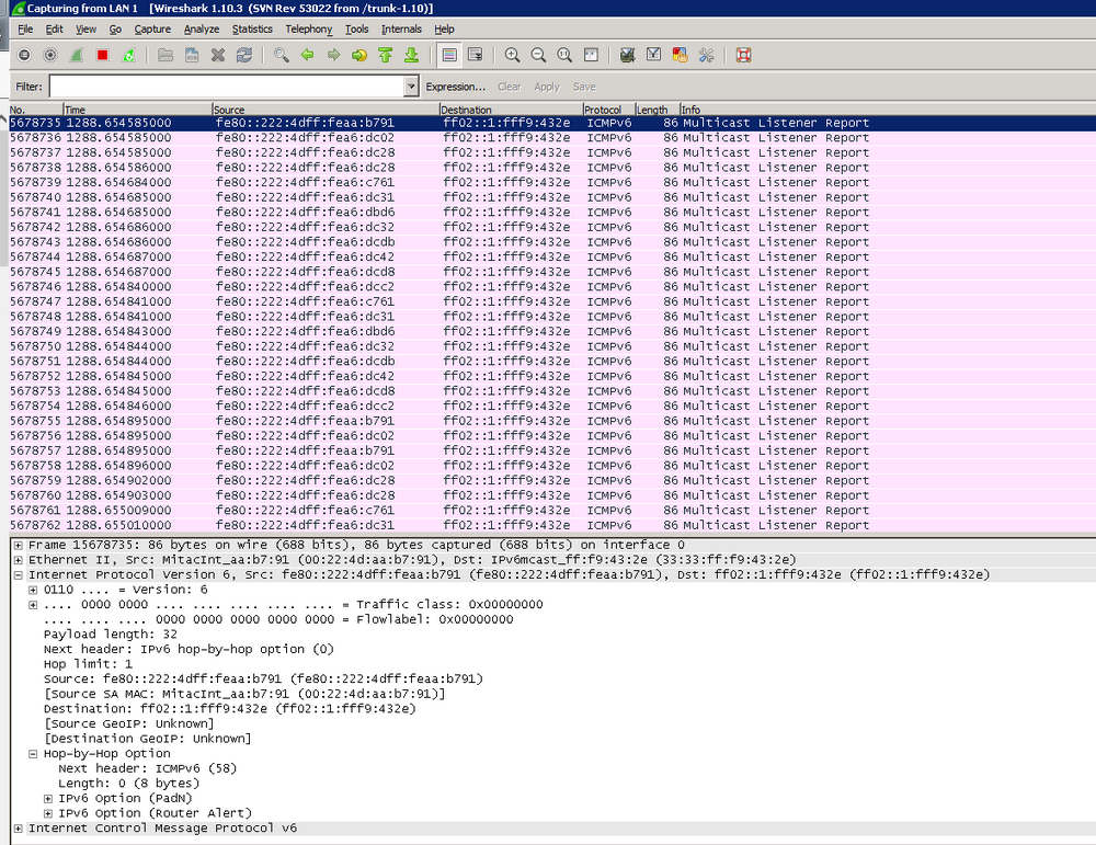

We had a single faulty NIC on a desktop that began flooding the network with broadcast traffic. It would cause the switch it was connected with to become completely non-responsive and then the traffic would slowly begin cascading across the network. We identified it with PRTG and the top 10 bandwidth report.
Fixed the faulty NIC and solved the problem. Maybe you have a bad batch of NICs (low probability) or mismatched drivers and OS, or an incompatibility with the motherboard, NIC, OS combination.
Do people with the issues have multiple vlans, or a single one, plus is IGMP on or off on all the procurves/vlans?
Multiple VLANs, IGMP turned on for the VLANs where we do multicasting.
