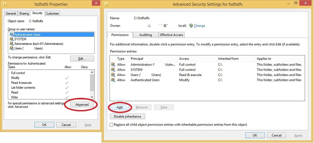

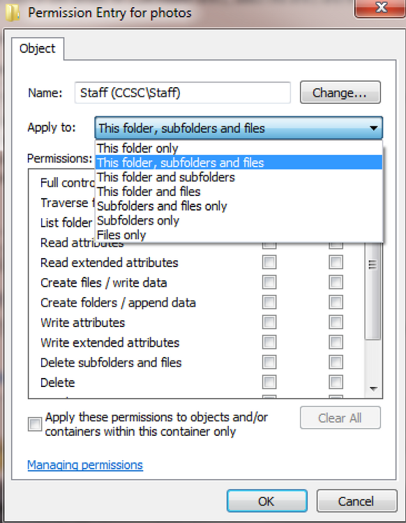

PERM.pngMake the root folder so the users can only read to 'This folder only' then on each folder change the permission so that user full control of sub folders and files only. You do this on the advanced -> change permissions page of the security screen. Edited by Quackers

I have just looked at the folders and I do not see what you showed me. There is NO "apply to" box
I have a security tab and an edit permissions button - not a permissions tab.

My mistake it is the Security Tab, its not called Permissions.
So from the security tab on the root folder (folder 1)click the advanced , change permissions, then uncheck remove 'include inheritable permissions from this parents object'
Then add admins, and system to full control to full of this folder, subfolders and files.
Then make users read this folder only, that will allow them into it, but not modify anything.
Then on folder 2 make it so that the user can read the folder, but full control to subfolders and files only, so the actual folder cannot be modified just anything inside it can.

on folder(must not be moved) you want to go to permissions advanced and add user group (pupils in my example) then select deny (AND ONLY STUFF THEY CANT DO SO LEAVE read etc blank) create file/create folders/delete) and make sure at the top it says this folder only
