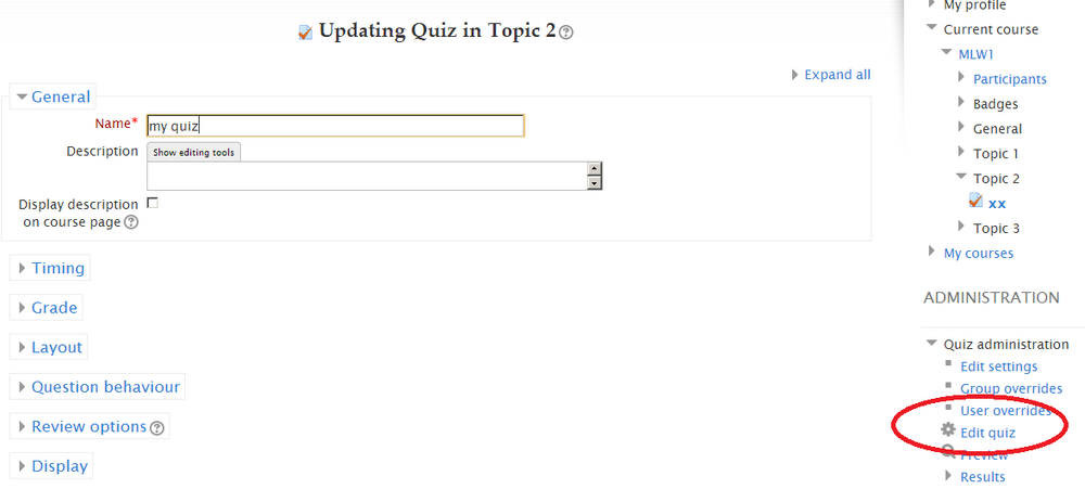

[ATTACH]20792[/ATTACH]
Here it is although I dont think it will help you much. Basically, you click on edit quiz but the list of question types does not appear
From your screen shot the moodle page footer is missing which would mean the page has failed to load correctly.
Turn debugging on to developer and tick the display error message box underneath and see if the page shows an error.
