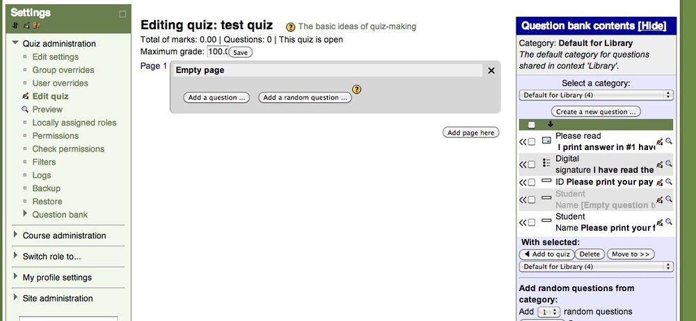

  13. I have 2.3 ...so it might be slightly different..but as mentioned in a couple other responses... look to your right when you are in edit quiz mode. (this is automatic when you create a new quiz and click save and display). Anyway, here is a screen capture for you. Couple expected quirks: Question category that is present has to have questions present (that may be why you dont see anything). Include show hidden questions, that makes the list longer. People dont look to the right and read the bar (blue in my case)...This question list can be hidden, so make sure it is showing the questions and not hiding them.
