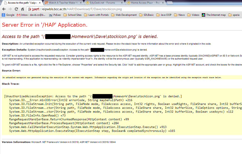

The file manager in HAP+ responds oddly to this. Because it can see the files, you still get the context menu listing download / Zip / Delete. Zip and Delete just don’t work and give the standard red error bar. However, if a student selects Download, you are presented with a nasty error page (see attached). I am hoping this is just a small issue with HAP+ that can be fixed, but my students are just happy we can list files and submit.
