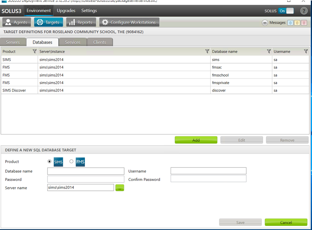

Thanks for the reply. I'll take a look at our Firewall to see if anything is getting stopped. It seems odd that when I click the update button in the main SOLUS settings it alerts me to X amount of updates its found e.g. SIMS 7.200.35 etc. Yet they don't appear in the main upgrades list. Could it be that SOLUS isn't recognising that SIMS is installed on the server SOLUS is on? In the targets list the servers aren't listed as any SIMS or SQL instances etc.
When I click on that I get a message along the lines of SQL targets cannot be created until a target database has been setup. On the first menu I am unable to manually add in any details to add the SIMS server in.
