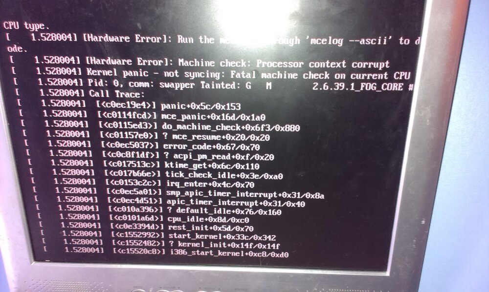

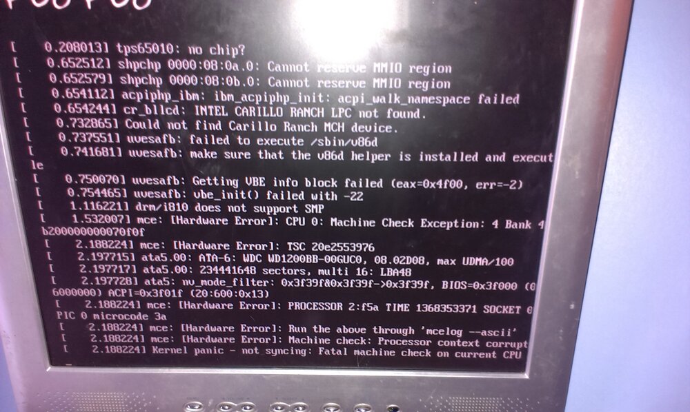

Iv got FOG running on a VM on my main machine (VM) while i test it out on my network. I have everything working DHCP wise but for some reason i cant seem to do anything on the FOG PXE screen.
If i try register the server it just freezes. When i try upload an image i get this problem:
Photo:
Any ideas guys?

Yep, and try some of the different ones such as the PS & kitchensink. I remember having to use one of them for our Dell 740 desktops as nothing else would work with them. We have the kernel specifically set for those machines and everything else uses the default newer kernel.
Thanks Ashm,
I take it this is for the FOG server yeah?
Just want to double check, Save me some research
Update:
Thanks Again Ashm.
kitchenSkin. worked a charm.
