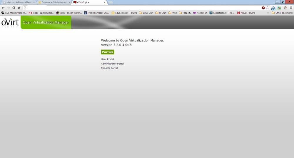

This is what we do here, we have hundreds of servers and virtual servers in our DC all running off of IBM Blade Center servers (IBM Flex System - United Kingdom) these arn't cheap and the juice for each power supply is 2500Watts and there is 4 in one server, we use Cobbler for Linux roll outs... we tried FOG but it just couldnt cut the mustard.
Cobbler - Linux install and update server
and we also run:
Spacewalk - Spacewalk: Free & Open Source Linux Systems Management
We roll out mainly CentOS images, prebuilt for architecture. The servers themselves run oVirt (oVirt) Which is actually Red Hat Virtualization but oVirt is free. All of the blades within the server are oVirt nodes. oVirt is self is a lot like VMWare but it's all web based, as is cobbler and skywalk. So all we do is VPN into the DC network and do what we need to do and with everything being web based we can do it all from browser and even do it from a very nice Asus tablet if we so wish!
If we spin up a machine say for some one to use for backups then we just create a user account in ovirt, and when they go to the oVirt portal you get a user login page. The user can then create machine on which OS they have specified so they create the machine and use the OS, so they get full access to the machine.
If you need any information let me know.
