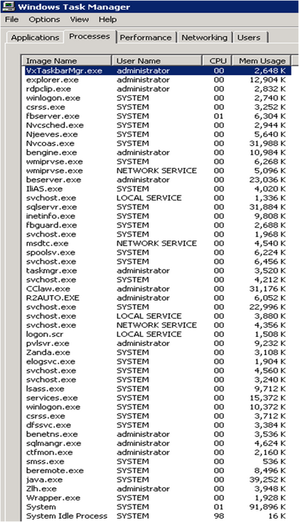

I've just tried both of the above to no joy. Below is a copy of my process table if any one can see what might be stopping the install I would be very happy. I've tried killing most of the processes but so far have no results
