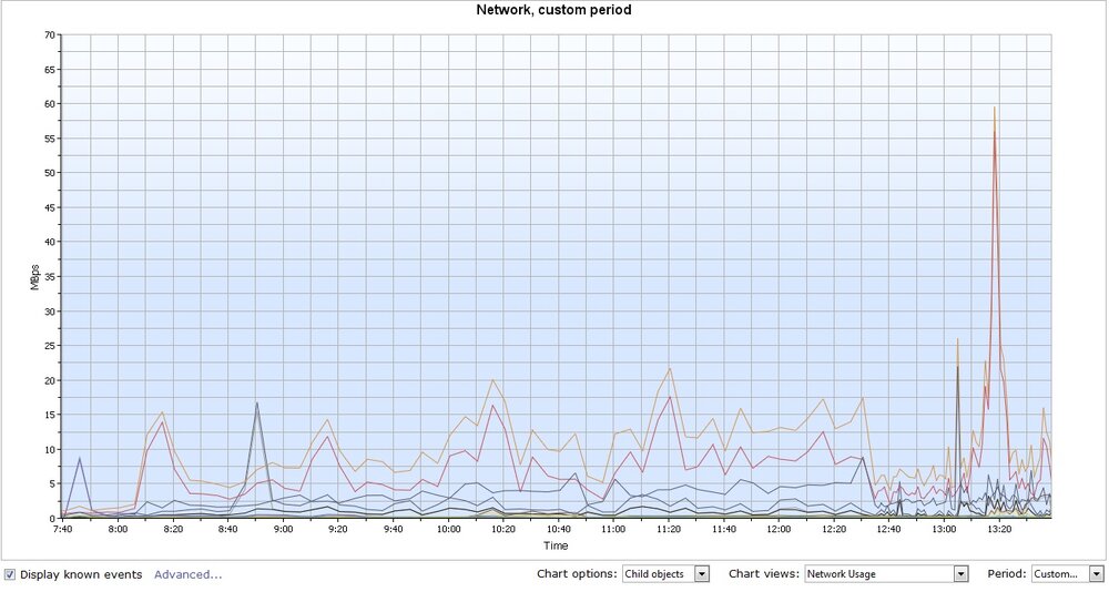

I would be interested to see what the utilisation (percentage wise) of the 10Gb connection is during a normal school day. We have a 4Gb trunked connection from each ESX and have never seen any of the nics that make up the trunks go much above 30%. This is across 3 ESX servers hosting 48 servers including SIMS, Exchange, Sharepoint, file services etc. The basic question is then what is the justification for 10Gb connections in a school environment? I seem to remember having this conversation before and never really getting a satisfactory answer.
30% usage does not nessisarily mean that that is all it would use and is an over spec, it could easily indicate a bottleneck in storage speed, virtual host CPU or memory queues or contention on the rest of the network fabric. Sure it could mean that in your situation it is all that you need but without all the variables we can't know if this is right even for your site let alone others.

As you can see from the attached image I use two IP ranges 10.blah.131.? for management & vmotion and 10.blah.16.? for standard curriculum traffic (subnets withheld for legal reasons:)). There is another VLAN (5) which uses the curriculum nics which is for DMZ stuff. This has another IP range 192.blah.blah.? Any layer 2 switch can deal with this.ESX nic setup.jpg. Hope this helps

1. That is true, this figure is an average over a period of time (1 half term's figures in fact) taken on a daily basis between 8:80am and 3pm (normal school day) and represents that average for that day (yes there were some spikes each day but none maxed out any of the nics). This figure was then recorded every school day for the half term and averaged over that time period.
