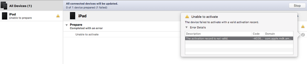

  2. Dear Team, I can't supervise new iPads anymore. Before I go in details you should know a few things: I use AP 1.7.2 OSX 10.11.6 (because if I upgrade AP 1.7.2 won't be compatible apple said to me) The mac I use has been restored from a TimeMachine after the other one had a mother board issue (not sure this is important) When I try to supervise a new iPad, I get the error: "The activation record is not valid". To supervise the iPad, all I do it give it a name and click supervise. I don't restore any backups or apply profiles to it yet... I tried supervising different iPads but no luck! I can still sync all the rest of my iPads and update apps etc etc. Any ideas?

  4. Is that iPad managed by Apple Configurator ? If so make sure to check what profiles are being pushed to the iPad and allow the iPad to be connected to any computer.
  5. Here is what apple says. You can also take a look at this. Ideally you would like to start fresh with a new OSX install but I think you can not download Apple Configurator 1.7.2 from the macstore anymore. It means you will need to move on to AC2 and I personally hate it ! It seems like TimeMachine is probably your best option i'm afraid.

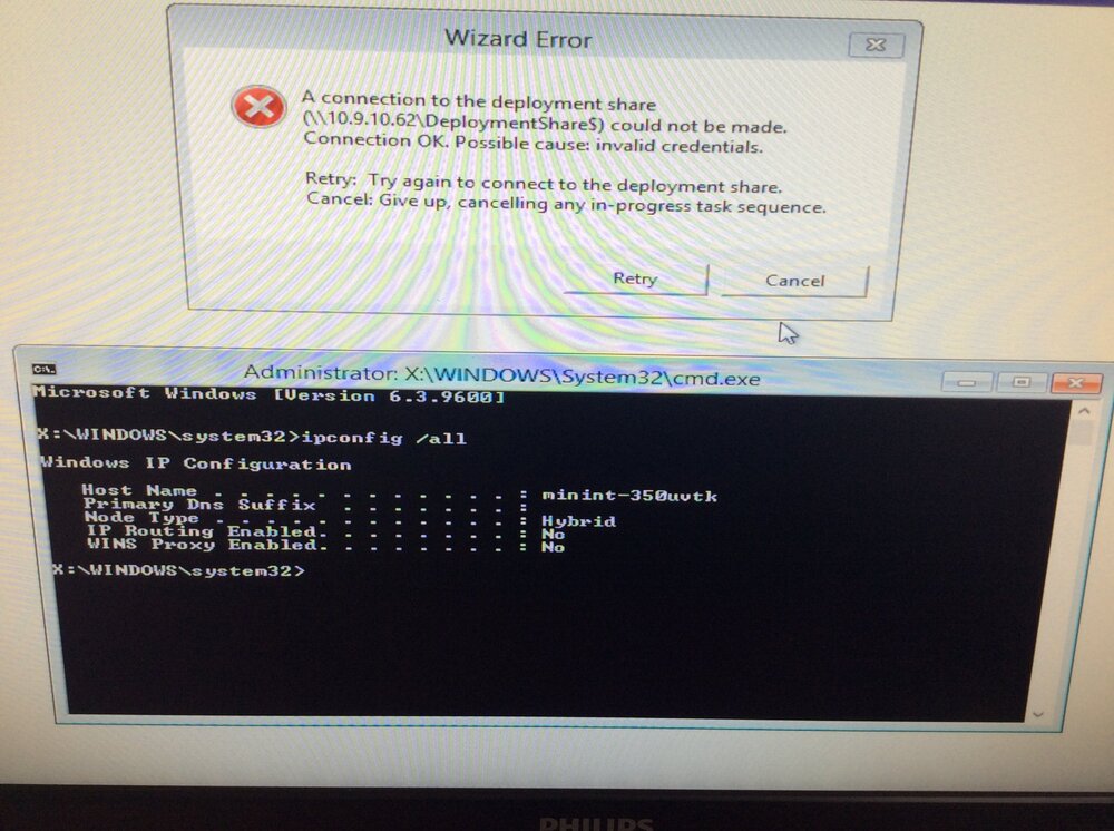

  7. Yes and no. I had to delete the driver from MDT and WDS. Update deployment shares. I then re imported the drivers and updated fully the deployment and it's now working.
  8. Thanks ! I'll add this to the MDT and WDS and let you know. I tried the previous version but this one seems more up to date.
  9. I didn't try the SP73440 but I will soon. If I can't get it to work i'll install windows via DVD and get the hardware ID.
  10. Hi, We have a few new machines here and i'm having issues deploying W7 x64. MDT Usually behaves perfectly but this time I can't make it work. As usual I added drivers to the MDT server, update the deployment shares, replace the Boot image on WDS but it won't go past the connection wizard. Here is a screenshot: As you can see it's not related to the credentials (no I didn't change my password and Yes the password is correct on the bootstrap.ini and rules). The machine can't ping anything and doesn't have an ip ad. So it has to be driver related. I go all drivers x64 form HP and added them to WDS and MDT but it still won't work. The exact reference of the ethernet card a Integrated Realtek RTL8111HSH-CG GbE. I tried getting PXE drivers straight for the Realtek website but can't find anything useful. Here is the PC. Anyone could help ?

  14. Hi, So it can come from 2 things: 1-if the iPad has profile on it, make sure your restriction profile allow the iPad to connect with an other machine that apple configurator or MDM. 2-if your iPad doesn't have a profile restriction, on your Windows, right click on Computer, Manage, go to device manager, then Universal Serial Bus (USB), right click of Apple iPad and uninstall drivers. Make sure you tick, yes delete curent drivers. Now connect your iPad, wait till the drivers are installed and boummm it works again
