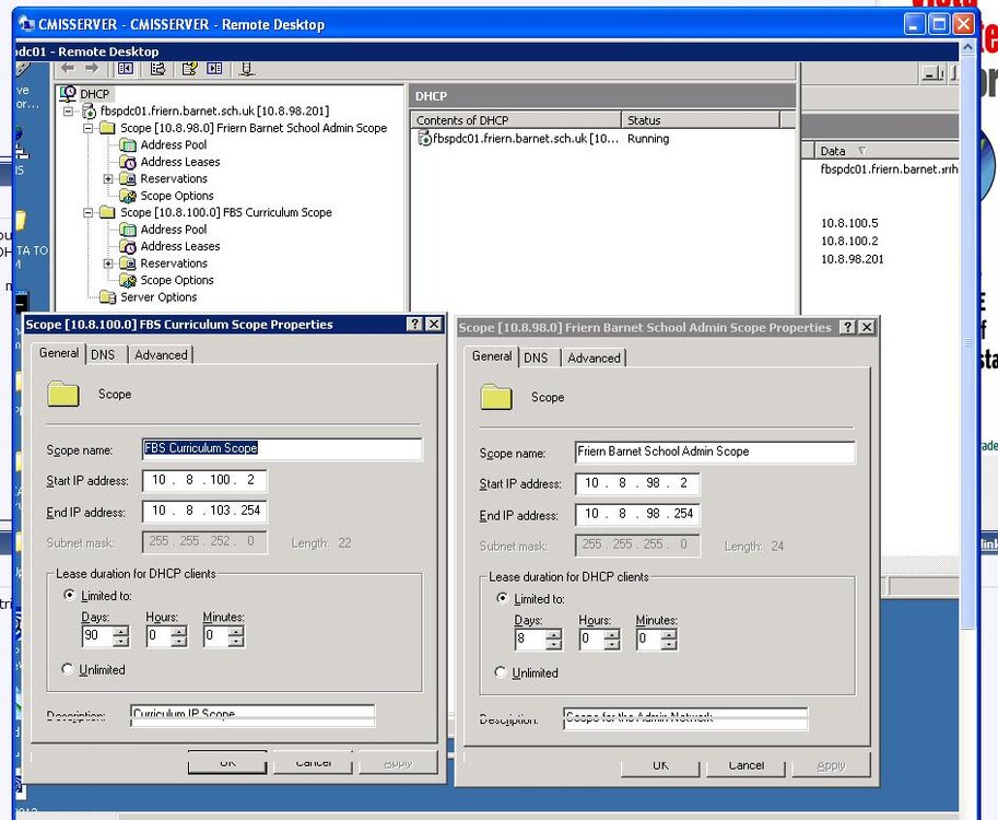

  15. Well the DHCP for both Admin and Curriculum was configured on the same server and we had no problem for the past few years, as we started to run out of IP addresses all I did is to delete the old Curriculum scope and create a new scope with bigger IP range, after the change this IP mixup is happening. here is the configuration for both admin and curr on the same server.
  16. We run DHCP services for both curriculum and Admin network on the same server. We have recently changed our IP address scope for curriculum network because it was running out of IP addresses. However after the change our curriculum PCs are now randomly picking up Admin IP addresses (some PCs receive CURRICULUM IPs and some admin IPs in the same class room feeding from the same switch). We then have to do IPRELEASE and IPRENEW, to force these PCs to pickup curr IP; but this keeps hppening over and over, please advice if you know why.
