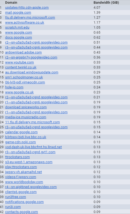

  19. The ActivSoftware is where it checks for a newer version, offers it to the users on startup and they are clicking yes to download it and never actually using it. Im going to roll out a newer version soon which disables the auto update check. Our connections are 20/20 but burstable up to 80 (we regularly get just under 70) and have two of those connections.
  20. Here's our bandwidth usage for Wednesday. Numbers 1 and 3 aren't normally on there but there must have been an iOS update and I also added some categories to our WSUS server so that explains the Microsoft ones.

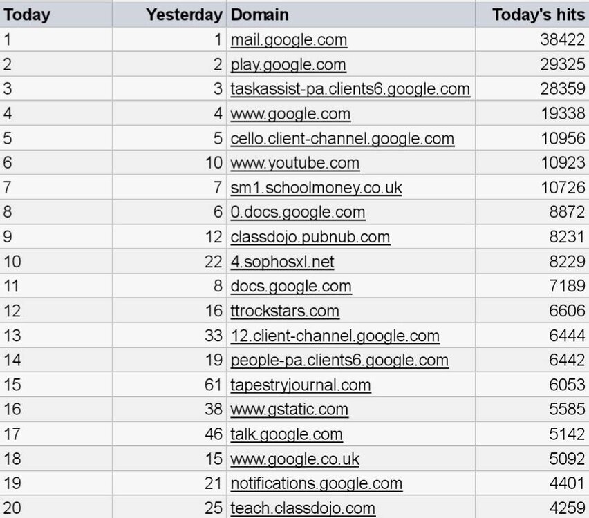

  23. I've now scattered the updates and hasn't changed anything. One of our highest hit URLs is play.google.com, I'm presuming that it's for apps/app updates on the chrome devices but is normal to have so many on just 30 chrome devices used for 2 hours?
  24. I'd have to check the version but we aren't seeing anywhere near that amount of hits. Out of curiosity, if you guys wanted to know the purpose of a URL, where would you go to search it? Basically there's a couple of Google ones and a search comes up with nothing but there might be a site that has a database of them and their functions?
  25. My assumption would be that it's not the updates as our Smoothwall would cache it and already had the phones have high priority but didnt do anything. The updates were scattered over a day but have now changed that to 7 instead.
