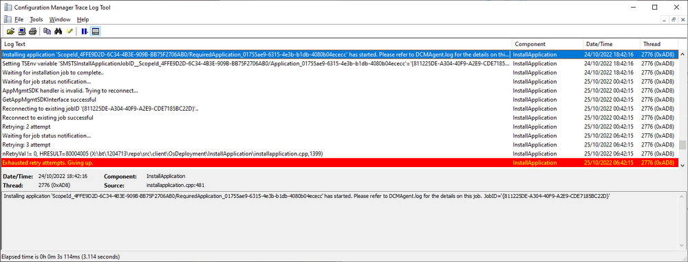

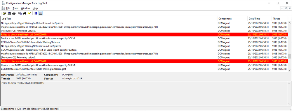

Hey, Am having trouble deploying Smoothwall Monitor using SCCM. We had our install last week and everything was deployed fine to all devices (apart from an immediate, unnotified restart). However, when deploying the same msi, on an OSD, it times out after several hours and fails the task sequence. I've taken a screenshot of the errors in the logs but not sure what it is. It says on the DCM log about waiting for reboot etc but with /norestart or REBOOT=ReallySuppress it doesn't make a difference. CMD line I'm using: msiexec /i "sw-safeguarding-client-2.8.0.msi" OrgID= SerialID= /q /L*V "C:\smoothwallmonitor.log" Hoping someone has come across this issue and can shed some light on it. Thanks

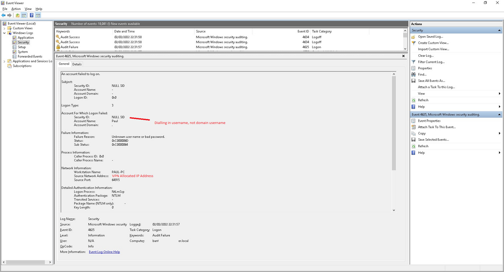

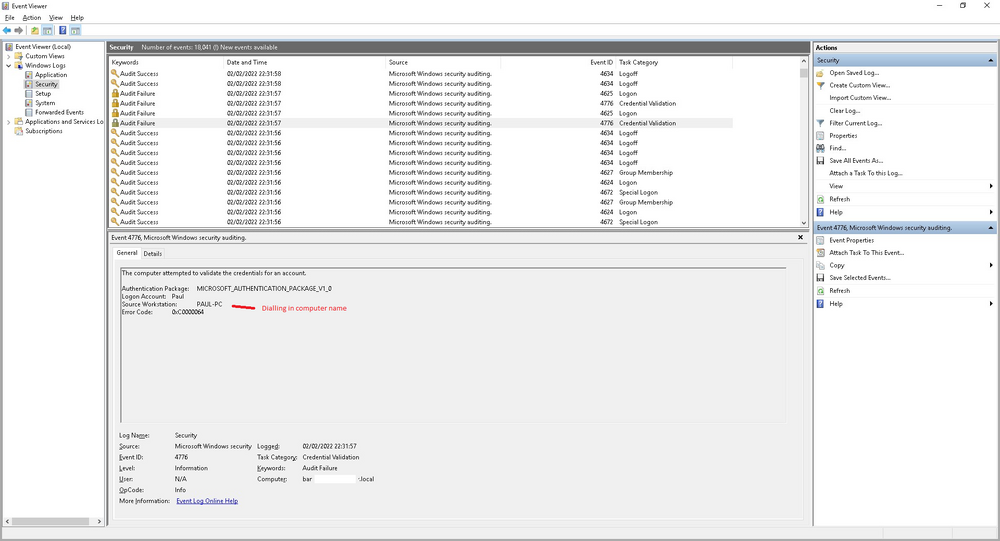

Hi, We are using RRAS for our dial-in VPN service (L2TP- with PSK) and all of a sudden, users are unable to access file shares using their domain credentials. What used to happen is they'd connect to the VPN, a VBS script would run to map drives and printers. As the VPN had logged them in using their domain credentials, there was no need to specify any credentials for home drives etc in the scripts. Now however, they are logged in... (I can ping the DC), the script says the password was incorrect. If I try and access the share manually via windows explorer, I receive: 0x80004005 unspecified error. But manually mapping the drive with credentials will work... The only thing that I can find is in the domain controller security event log (the RRAS server's entries look fine) screenshots are attached. Perhaps I'm not searching online for the correct keywords but I can't seem to find anything that will help. As you can see, the dial-in computer's user credentials are being used to attempt authentication (not domain) with the domain controller having just been authenticated by the RRAS server using them??? Any help is appreciated by me and lots of frustrated teachers Thanks, Paul
