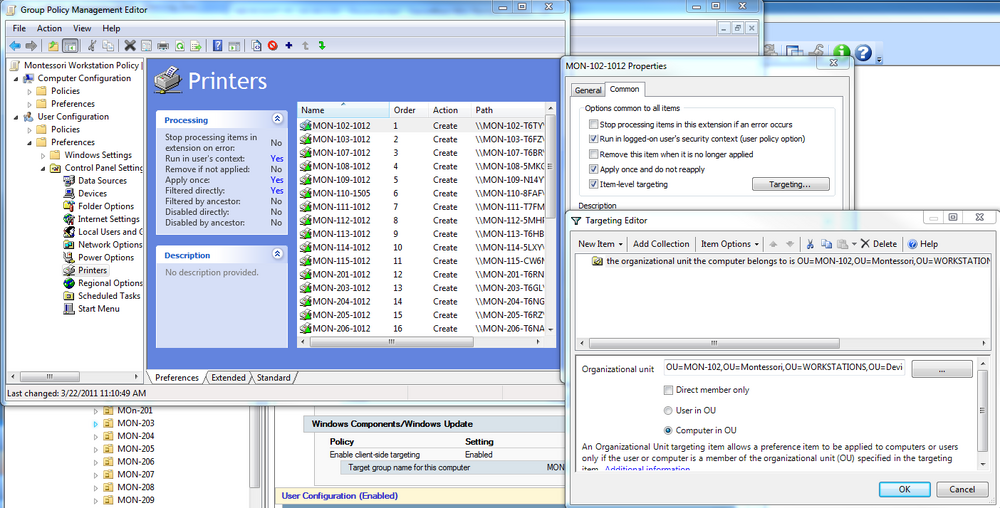

  6. ^This as he said... And if you want you can also change it from "CREATE" to "UPDATE" and then in the Common tab uncheck the box for Apply once and do not reapply. This will make sure it processes every login. Just note that it will be a tad slower logging on to process the group policy each login.

  9. Yes with the steps I provided it works with a Computer in the OU ... if you want to use users instead you need to switch it to where your Users are and select Users in OU option. We found it was easier to map printers based on the computer location rather than the user since users move around a lot. Make sure you only set one of the two printers to be the default. I can't remember but I want to say having it second in the list and making it the default worked better, you'd have to tweak it until you get the results you desire, but it sounds like you're almost there.

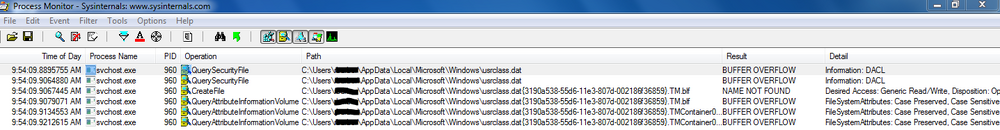

  10. Killed my excitement with that link. We were hoping we were on to something since we only see the buffer overflows on affected profiles. From the log the only things in there are Microsoft files, along with the Bonjour (Apple) entry in the log and the Microsoft Forefront TMG Firewall client we use.
  11. Getting Buffer Overflow errors see attached:
  12. Sorry, you'll need these settings as well:

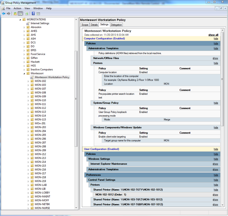

  13. Here's a screenshot of our GP setup. We break down all of our Workstations --> Building --> Room Then we have a workstation policy for that building with the following settings and utilize the printers there. This way it always maps the printers (even USB printers) for any user that logs in to that room without the need for a VBS script. It's been working flawlessly for us for almost 3 years now. Takes a little work to get it all in the GPO's but once it's there it's not so bad. Just make sure you have a good policy in place if your technicians replace/add a printer so it gets updates. Edit: I should also note that we set it up so that each of our school buildings only show their buildings printers if they manually add a printer, which makes it a lot easier if they can't find theirs or want to print to an alternate location. We just trained them to add them manually as they need them, and auto-map the most logical/closest printer. This also works for us because we set our computer names to BUILDING-ROOM-SERIAL.
