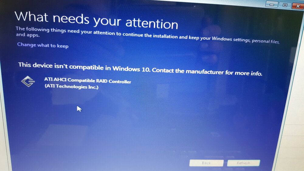

  6. Sorted The machine has 2 drives Rebooted - pressed Ctrl+F to get into the RAID settings Deleted the Raid Array using number 3 (I think this deletes your data!) Removed 1 disk anyway (cuz I wanted the other one) Booted from Win 10 DVD and installed Windows - no complaints this time Cheers
  7. Well I downloaded a verion of Win 10 iso and burnt a disk On installing it says it cant read the HDD and needs a driver - where is the best place to get the RAID driver ? Thanks
  8. In the BIOS, I can only see RAID is Autodetect or ON - under SATA operation If anyone can see how to do a clean install without paying, then please let me know. I know upgrades are free, but to boot it from a Win 10 DVD bypasses that doesn't it ??
  9. The RAID is ATI 2+0 Stripe/RAID0 SCSI Disk Device Dated 2006 Not sure how to update this...
  10. Yep 2 drives both 160Gb with 2Gb RAM RAID is set to Autodetect. There is no setting to switch RAID off that I can see
  11. Do you mean a BIOS update Also, I am not doing a clean install - it is an upgrade from Win 7 Thanks
  12. Hi I am trying to upgrade Win 7 to 10 on a Dell 1721 It gets as far as pic attached Is there a workaround - can I disable the RAID Thanks
