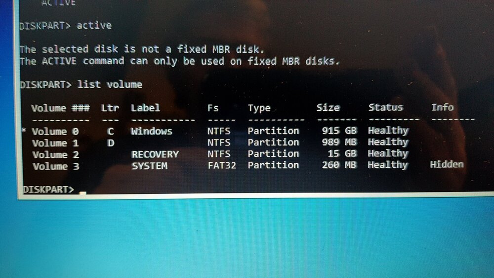

Keeps going to Repair Tried Bootrec etc, but it can't find a BOOT folder Plugged the HDD in via USB and am able to navigate to folders etc (not BOOT) Not sure why a small partition has a drive letter .... Any help appreciated !
