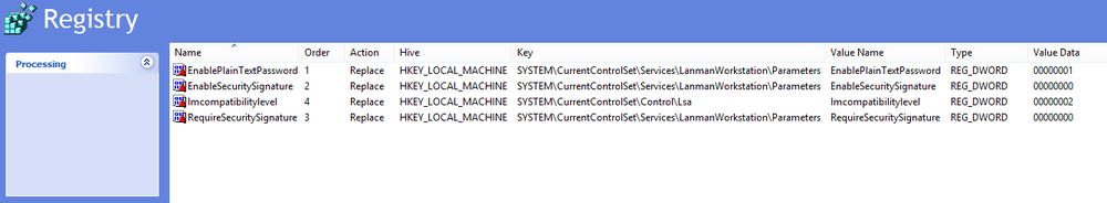

rich_tech Posted March 1, 2013 Report Posted March 1, 2013 ours is now solved, there were four registry entries that we had to set with GPP now and the device is visible properly and maps without issue. Subnets were always fine with us, the Linkstation was always visible even on machines it refused to map, it could be pinged fine, just point blank refused to map. Those are the settings for those wondering that have solved it for us.
mac_shinobi Posted March 1, 2013 Report Posted March 1, 2013 (edited) ours is now solved, there were four registry entries that we had to set with GPP now and the device is visible properly and maps without issue. Subnets were always fine with us, the Linkstation was always visible even on machines it refused to map, it could be pinged fine, just point blank refused to map. [ATTACH=CONFIG]17403[/ATTACH] Those are the settings for those wondering that have solved it for us. Aren't those settings to do with SMB Signing ( either version 1 or 2.0 ) ?? http://www.petri.co.il/how-to-disable-smb-2-on-windows-vista-or-server-2008.htm http://blogs.technet.com/b/josebda/archive/2010/12/01/the-basics-of-smb-signing-covering-both-smb1-and-smb2.aspx Edited March 1, 2013 by mac_shinobi
