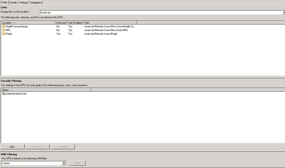

WMI.png Photos anit showing :(
Ok, I think i found it. Is it something to do with that^
Do i need to copy the GP and create an another wmi filter and give to non-64bits

run rsop as that user should tell you which policy is applying the ntserver bit
What am i looking for? It just pinning to the 32bit area. Not the 64bit.
