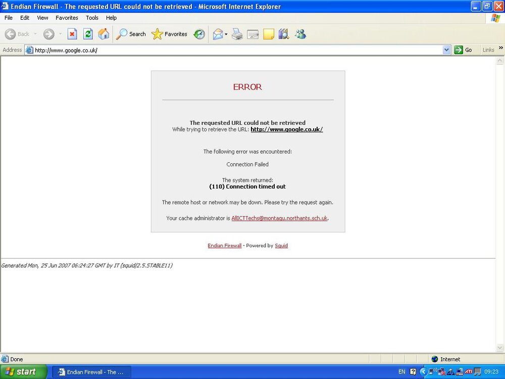

Craig_W Posted June 25, 2007 Report Posted June 25, 2007 I am trying to set up Endian Firewall on a test machine, witha view to using it in the very near future. I have installed it and gone through the network setup and entered all our internet connection details. The main "System" page within Endian says Connected with a green box, which I believe means it has a connection with the internet. I have entered what I beleive to be the correct proxy settings on the conneted laptop, but when I try and access any webpage Explorer just sits there and will then give me the Page Cannot be Displayed. I have seen (before the weekend) the Endian Firewall Timeout page occasionally. I am new to this so bare with me! Does anyone have any obvious ideas, common things that I have forgot?
Craig_W Posted June 25, 2007 Author Report Posted June 25, 2007 Here is the Endian Firewall Timed Out Screen im getting.
Craig_W Posted June 25, 2007 Author Report Posted June 25, 2007 I have now got this working. Needed to enter proxy details in Upstram proxy. We are now looking at using Endian, and are looking at servers. Could anyone recommend a good server spec that Endian will run on? Will Endain work happily with dual/quad core processors?
