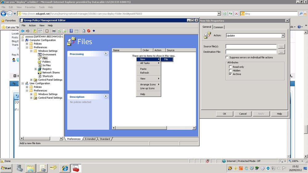

Alternatibe to scripting could you have done this through GPP under the computer startup>Windows Settings> Files/Folders. Use Item level targetting to check if the folder exists should do the same thing without having to check syntax.

Not true, use the Files Extension to copy the files in one go:
Group Policy includes the Files preference extension. For computers or users, this extension allows you to:
  • Copy a file (or multiple files in one folder) to a new location and then configure the attributes of those files. New subfolders are created as necessary.

where im on an 08r2 box and cant see any way of doing multi files

Looking at r2 here as well, directly above the 'Folders' option in GPPs is 'Files' - you specify a source and destination and it copies.

if i select a folder it just opens it thats how ive been doing odd files like ini files
But have you ever tried using wildcards in the source path?
From the GPP help:
Source file(s) Type the location from which to copy the Source file(s). This location can be a fully qualified UNC path or a path on a local or mapped drive from the perspective of the client. This field can contain variables.
This field can also contain single character (?) and multiple character (*) wildcards, allowing you to copy or modify multiple files.
This option is available only if the action selected is Create, Replace, or Update.

honesly no as its gui based i assumed it would let me shift/control/folder select if it allowed it hmm i will have to have a look at that one day.
so instead of having \\server\share\folder\file1.txt i could paste \\server\share\folder\*.txt there etc?
Only just noticed this, but if you put a * in the path the 'Destination file' box is relabelled to 'Destination folder' (not completely intuitive!)
So yeah you put source = "\\some_server_share\files\*" and destination = "c:\files_here_please" and all the files would be copied from the server share to the local machine.
its letting me do it but files arnt being copied (granted its a slightly lazy copy from netlogon to test) and the folder exists i gppd that as well that worked fine

[ATTACH=CONFIG]15315[/ATTACH]
I've done it without the *.* in the destination...so you would have C:\Test01\. Not sure if that makes a difference or not to be honest.
yup sigh :doh:
dosent seem to do subfolders though (though that may just be a case of waiting i suppose after gpupdate /force)
typical i log off give it one last check and my extra folder copied across :doh:
