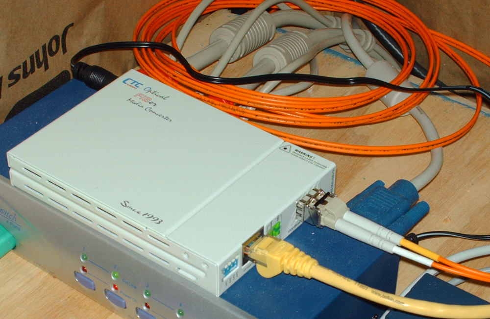

Could be a fibre media converter, have you tried rebooting the switches and converters, if they are managed you could try to log into them to see if there are excessive error on the fibre link, those converters do burn out.
The first thing i was going to do tomorrow was a reboot. I dont know any of the IP addresses of the switches are managed. The whole network was basically left in a really big mess!
If its the fibre burning out - would it be possible to ditch the fibre bit and just plug the ethernet in? for a temporary period atleast? The mian office and admin area is one that is affected so i need to get them on somehow?

Not good from an electrical point of view but yes, you should be able to yank the fibre and connect via copper as long as the cable run is less than 100m which should be good for testing. If it is that I'd replace the fibre converters though, they are not that expencive and you may be able to replace 100mbit ones with GBit depending on what is there already.
Okay - This seems very likely.
With the media converters - it converts an ethernet to fibre? but from what i remember the connection between the buildings are still ethernet - i may have that wrong it was only a quick check. i havnt got a cable long enough to replace the whole main cable?!?

Your diagram was a little perplexing, from what I could gather it seemed to indicate that there was both fibre and a copper link between the buildings, that one random PC. You'd use that link and plug that into the other switch. It is common for copper links to still exist if a school has moved to fibre later.
You are right about the converter, it just takes a ethernet cable and converts to fibre, one of those at each end and you can use fibre transparently to cheaper switches, they don't know the difference. The usually look something like the white box here:
It does look like that but theres 2 boxes at each end with fibre. That little box is connected to a bigger box which is connected to the link.

One other thing to consider, if the fiber converters are in an open area then someone may have been playing with the dip switches that are common on these devices. If there is a speed or duplex mismatch then you will have some dreadful performance.

I think its fibre! Its defernatly the cable connecting both together. It looks like an ST connector on one end.

It does look like a fibre fault or indeed a duplex mis-match. Personally I try and avoid media converters, as it's one more link in the chain to go wrong. Installing fibre modules, such as a Cisco GLC-MM-SX will give you a dedicated 1Gbps link over OM1, OM2 or OM3 fibre and allow you to manage it properly both ends. All major manufacturers adhere to this standard.
Yeah its looking likely to be the fibre. whole network went agian today apart from the 2 switches that are not connected via the fibre. I didnt have time to do alot of testing today but im planning on connecting all 4 switches together not through the fibre and seeing if it works. If we get back up and running then im assuming its the fibre. I also want to test if 2 computers can communicate on the switches that arnt connecting the the network (if that makes sense) to rule out problems with the switches.

Did you only replace one?
I'd recommend replacing both especially if you didn't get the exact same make/model as a replacement.
