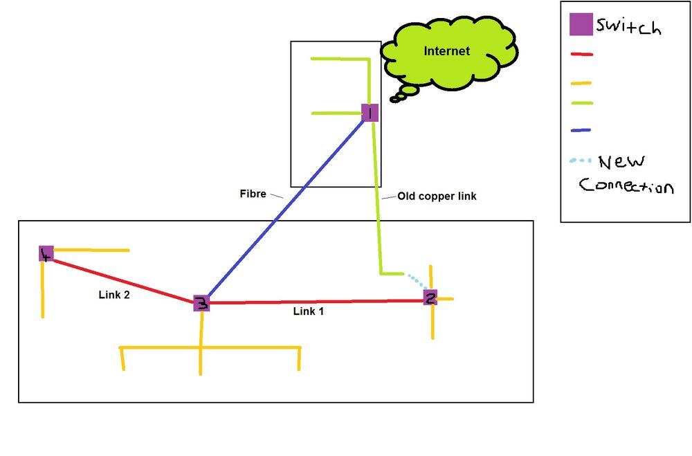

  18. Yes i did get 2 new ones. That is the plan for the future. Hopefully the very near future when i install the new switches over the summer. The new converters i got were only £20 each as a temporary measure to get it back on. Thanks

  20. It was one of the media converters by the way! Thanks for everyones help.
  21. Yeah its looking likely to be the fibre. whole network went agian today apart from the 2 switches that are not connected via the fibre. I didnt have time to do alot of testing today but im planning on connecting all 4 switches together not through the fibre and seeing if it works. If we get back up and running then im assuming its the fibre. I also want to test if 2 computers can communicate on the switches that arnt connecting the the network (if that makes sense) to rule out problems with the switches. Working at 2 schools means i dont have alot of time when something like this goes wrong. I cant leave one school to go to the other as im on 2 seperate contracts for each. Meaning it just has to wait which isnt great.
  22. No it wasnt connected before. All i did today was unplug link 1 and plug in the copper connection to switch 1 and the whole network went back to normal. I agree with what you say. The person taking care of the network before me didnt document anything or keep any records of anything. When i started all they passed on to me was the administrator password. None of the teachers laptops or office computers are actually on the domain there just stand alone computers. Most of the network is on the way out. i have 3 new managed switches to replace 3 of the old netgear ones. a whole new set of desktops and laptops and liceses for Windows 7. (Currently on XP). So as of the summer holidays most of it will be started from scratch anyway. (and everyone will be on the domain!) Thanks for all your help.
  23. Quick update - Ive found a temporary fix but i dont understand what ive done to fix the WHOLE network (I just thought it would fix the office computers) As you can see. I used the old copper connection to try and get the 2 office computers working and unconnected link 1 - thinking this would only get the office working along with the IT suite. But everything worked after disconnecting link 1 and connecting the old copper link. So from what i can work out the fibre is working. Could a dodgey cable on link 1 have caused this the whole network to stop - apart from the computers connected via switch 1? or do you think ive somehow disconnected a loop by taking out link 1? if i have i have no idea what loop - it must have something to do with old wireing. (all the yellow and red lines are parts of the network not working yesterday - the green ones were working) Thanks again for all your help.
  24. Thanks - i will try this also. I do have a spare switch which could replace a faulty one. i have no idea what dip switches are but there not in an open area so i hope nobody has done anything to them! ill look into that aswell!
