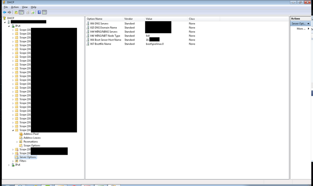

The client is complaining that it hasn't been told where to look for the boot file. It gets this information by setting the options correctly in DHCP. All you have to do is copy what is in options 66, and 67 from the working scope, and recreate them them as server options. Scope options only affect the subnet that scope was create for; where server options will affect all scopes the server hands out addresses for.
I've included a PNG of what it basically looks like when viewing the DHCP snap-in. Server options are highlighted and options 66 and 67 need to be defined in this section. Open the scope that has WDS working and get the correct values from there. Don't use mine as my WDS server is extremely customized.
