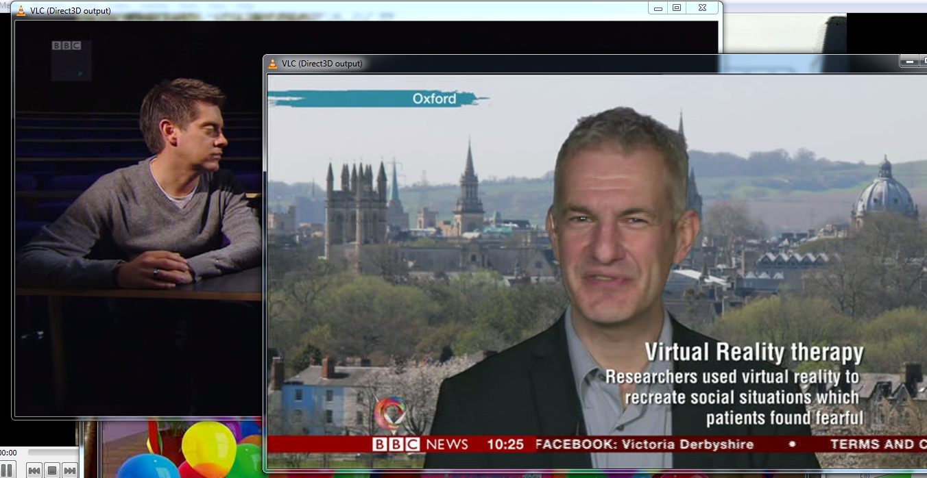

pslater Posted May 5, 2016 Posted May 5, 2016 Sorry to bring back such an old thread but I have a slight problem. I have followed the guide shown above and it works perfectly all except that both VLC and XIBO show all of the channels on the frequency in seperate direct3D output windows rather than the single channel that I want to stream. Can anyone help?
