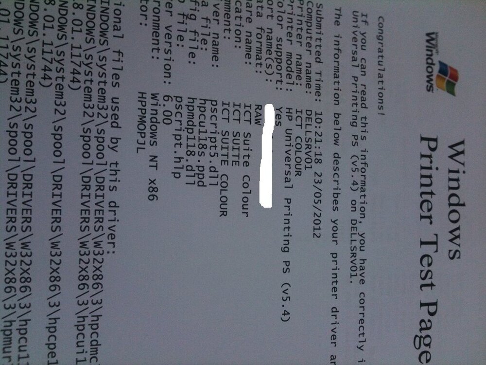

Well i have just tried a different driver the HP universal ps5.4 driver. i have taken a picture of the test page.
Can anyone point me in the right direction.
