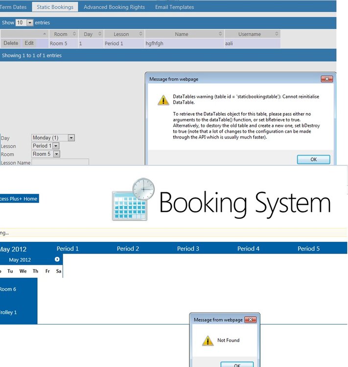

Thanks for you reply - have tried again to no avail - i just cannot get this working , its shame because i really want to use the room booking its main reason i installed it, previously used v6 in last school and worked well - , i hope someone else has some suggestions as im at a loss...
We use 7.10 of everything else but then I downloaded the 7.9 full install and replace the 7.10 booking system folder with the 7.9 version and that seems okay
Just tried this still getting the error very strange - ive even tried a new server and installed from scratch same thing?
With the static bookings page, can you replace the ~/bookingsystem/admin/default.aspx with the new one available on source control: Home Access Plus&#43
thanks nick but now get error
The type specified in the TypeName property of ObjectDataSource 'termdatesDataSource' could not be found.
Open that page in notepad, go to each line it throws an error for and change HAP.BookingSystem to HAP.Data.BookingSystem

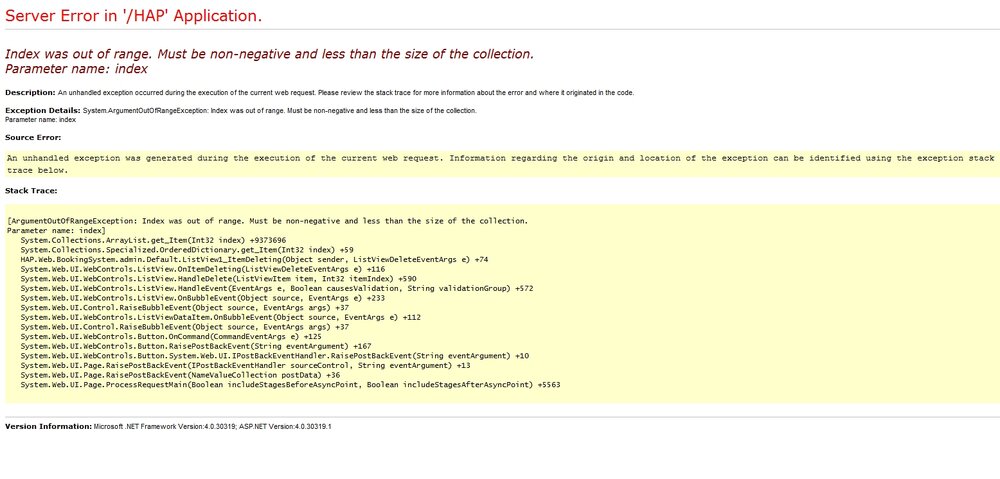

thanks nick - have done that now and when i try delete a static booking an error comes up again
Server Error in '/HAP' Application.
Index was out of range. Must be non-negative and less than the size of the collection.
Parameter name: index
Description: An unhandled exception occurred during the execution of the current web request. Please review the stack trace for more information about the error and where it originated in the code.
Exception Details: System.ArgumentOutOfRangeException: Index was out of range. Must be non-negative and less than the size of the collection.
Source Error:
An unhandled exception was generated during the execution of the current web request. Information regarding the origin and location of the exception can be identified using the exception stack trace below.
Stack Trace:
[ArgumentOutOfRangeException: Index was out of range. Must be non-negative and less than the size of the collection.
Parameter name: index]
System.Collections.ArrayList.get_Item(Int32 index) +9373696
System.Collections.Specialized.OrderedDictionary.get_Item(Int32 index) +59
HAP.Web.BookingSystem.admin.Default.ListView1_ItemDeleting(Object sender, ListViewDeleteEventArgs e) +74
System.Web.UI.WebControls.ListView.OnItemDeleting(ListViewDeleteEventArgs e) +116
System.Web.UI.WebControls.ListView.HandleDelete(ListViewItem item, Int32 itemIndex) +590
System.Web.UI.WebControls.ListView.HandleEvent(EventArgs e, Boolean causesValidation, String validationGroup) +572
System.Web.UI.WebControls.ListView.OnBubbleEvent(Object source, EventArgs e) +233
System.Web.UI.Control.RaiseBubbleEvent(Object source, EventArgs args) +37
System.Web.UI.WebControls.ListViewDataItem.OnBubbleEvent(Object source, EventArgs e) +112
System.Web.UI.WebControls.Button.OnCommand(CommandEventArgs e) +125
System.Web.UI.WebControls.Button.RaisePostBackEvent(String eventArgument) +167
System.Web.UI.WebControls.Button.System.Web.UI.IPostBackEventHandler.RaisePostBackEvent(String eventArgument) +10
System.Web.UI.Page.RaisePostBackEvent(IPostBackEventHandler sourceControl, String eventArgument) +13
System.Web.UI.Page.RaisePostBackEvent(NameValueCollection postData) +36
System.Web.UI.Page.ProcessRequestMain(Boolean includeStagesBeforeAsyncPoint, Boolean includeStagesAfterAsyncPoint) +5563
Version Information: Microsoft .NET Framework Version:4.0.30319; ASP.NET Version:4.0.30319.1
You need to add some rooms, or some lessons, that's what that error is about
nick i do have 2 rooms and 3 lessons when i try delete a static booking i get that error i cant delete any static bookings, also do you have any idea on my other issue with being unable to see the calender or book rooms.

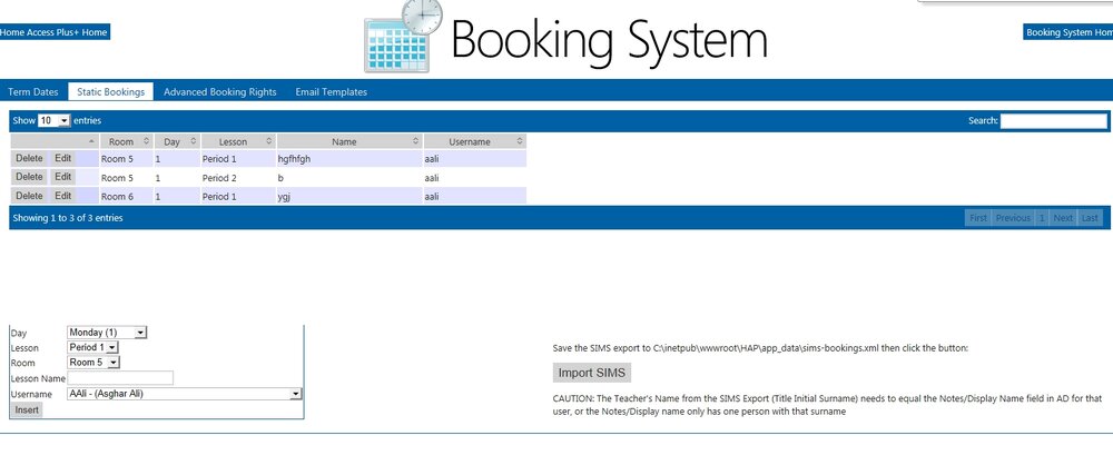

Ok, you can delete the room manually from the staticbookings.xml file in the app_data folder
Thanks nick that worked
