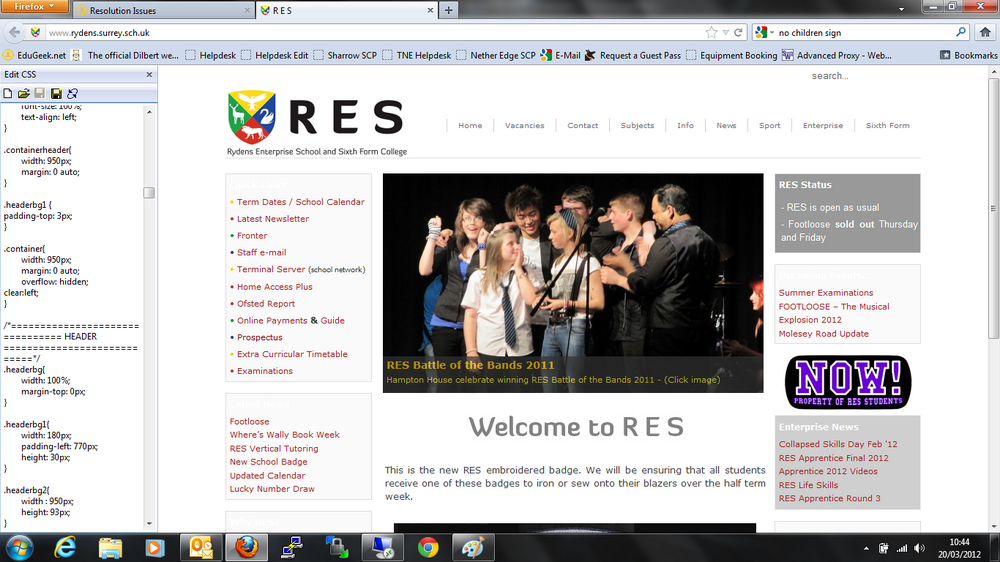

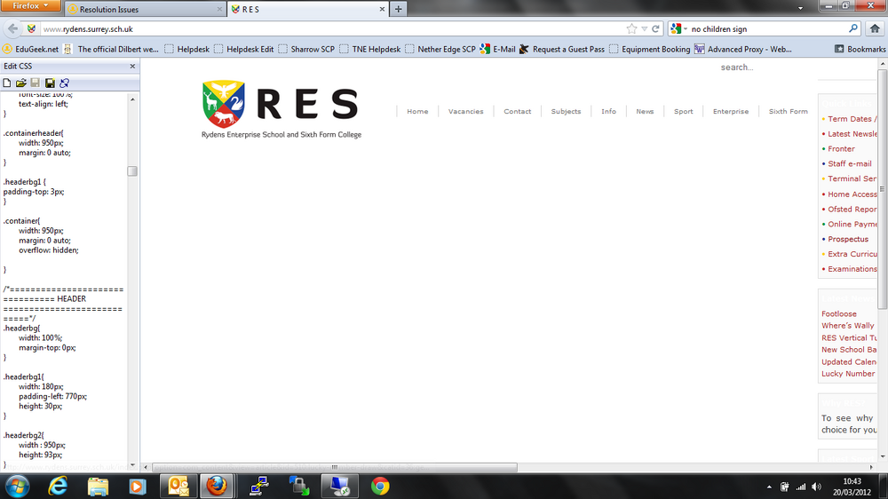

Hi,
Yes It was in template.css in the axe rescheek red template withing .container on line 116.
Here is my before and after screenshots. These are just in firefox as I can't test other browsers as I only have the edit css add on for firefox.
Working my end on Chrome too, will test safari this evening.
