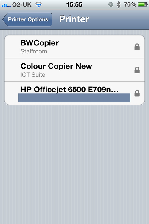

I can now see my shared printers, but, they all have locks on them.
I did have a lock on the printer when viewed via my iOS5 device so I activated my Guest Accounts (see below). Then I stopped and restarted the AirPrint under Services (Control Panel/Administrative Tools?Services/Airprint) and Voila!

Thats the thing, you cant authenticate in iOS5 like you could previously, hence why you need an account that uses no authentication (i.e guest)
