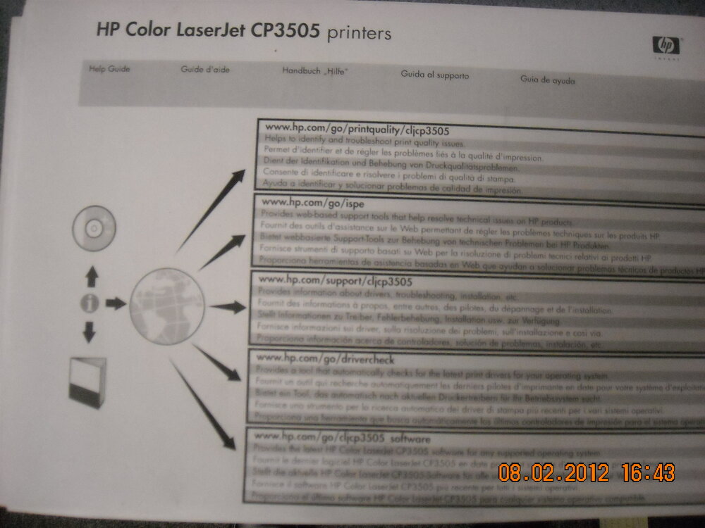

User are able to print with no major issues....occacionally the print spooler on the server does funny things...
However a few times a day per printer the printer churns out a HP help page....nothing interesting or helpful on it...just a few boxes with text in different languages...
its now getting annoying and wasting paper and toner....
any ideas of a fix?

Do you find this happening over the weekend whilst no-one is onsite?
DT
it happens randomly morning, noon and and night regardless of if one is on site or logged onto the network.
been through menus etc on the printers but cant find owt
if it was 1 printer then i wouldnt be to bother but as its all of them.....its a concern
also i cant change the driver to PCL5 or 6.?? as they refuse to print in colour....
ta
My first action would be to entirely rule out the possibility of user involvement by locking down their permission.
Secondly, unplug the cat5. leave it plugged in and powered on, see if it persists - if it does (which I suspect it will) then it's likely a system or firmware issue. In which case a call to HP is required.....
DT
I'd be inclined to try model-specific drivers as I've found that UPD doesn't work with some models, regardless of what HP might claim (OJ8000, k8600, CLJ2605). If you can't find them on HP's site or in Windows, try downloading from MS catalog site.
id try disabling the buttons on the printer itself (can often be done via web page or just on the worst offender sticky tape a thick bit of card over it) i usually find those pages come out when someone has been leaning on a control panel button
The difficulty is when serving x86 clients a printer install from an x64 server (which I'm currently setting up at the moment) is that more often than not (HP, I'm talking at you, you bunch of useless gits) you will get a universal driver for x64 but a proper driver for x86. If you want to share the printer, you appear to HAVE to install the UPD for both :(
had same problem with the same printers.... Got so fed up trying so many things, i built a 2003 32bit virtual server, joined it to the domain and used it as a 32 bit printer server. No more problems :)
