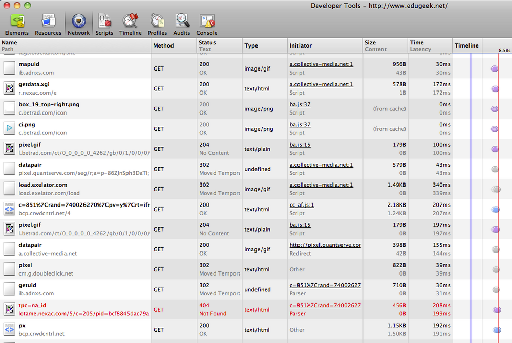

Chrome's web dev tools is useful for a item-by-item network speed log:
