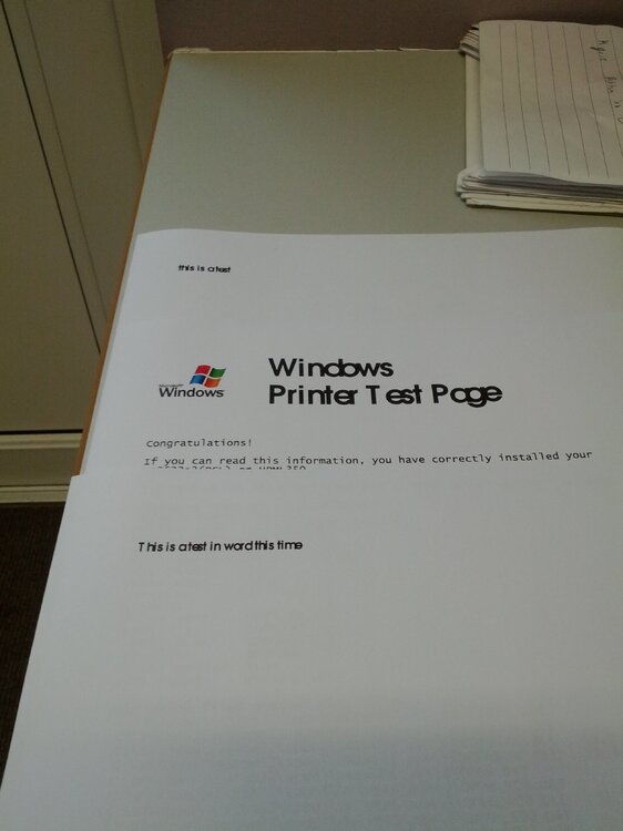

I have a very strange problem effecting one of my machines when trying to print times new roman.
On the screen it looks fine but when you print it it seems to change font and mess up the character spacing
I've tried removing the printer drivers from the machine and re-installing them from the print server but that didn't solve the problem. I removed the font and copied it onto the machine from another one that works.
I can't think of anything else that could effect how a font appears on the paper, times new roman comes out fine from any other machine...

I will try these next time I'm in the school. Its just strange that its works fine for nearly a year and now its suddenly developed this fault whilst the identical thin client host next to it is un affected.

After trying everything here it still had the same fault. In the end telling the printer to substitute times new roman for times new roman fixed it...
