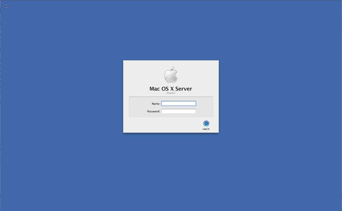

Clients are now showing me a Mac OSX Server login screen
As above really, was just on the verge of having these machines working correctly with AD (network drives and authentication) and OD (settings) and when i restarted them they've now all got a Mac OSX Server login window.
Why would this be?
How can i fix it?
Help really appreciated!

Also the machine does not do this unless i bind to AD/OD. They stay sitting with a normal login screen until i bind them, then some short while later if i restart they get the server login screen.
They then fail to use AD accounts, but as tested late yesterday can use OD accounts.
If i unplug the Mac server from the network they then fail to log on at all unless locally.
Ok i might be getting somewhere.
Just realised my iLife 08 package wasn't installed on this machine i was tinkering with (and was behaving itself), so i rolled it out from ARD and restarted and bam! the issue presented itself.
Then i realised i created the iLife package on the server.
